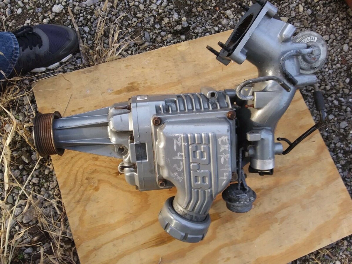

Not to derail @Dirtman 's thread (LOL), but I've been thinking pretty strongly on dropping an M90 on top of the 4.0 with the Moddbox kit, but I'd have to get the SC pretty cheap. $2000 for 60hp seems a bit steep.
I have a M?? off of a 3.8 but it's the one setup for tubing and an intercooler. I'm not certain what model it is.
3.8l Ford or Gm?
Post a pic.
Some of the 4.0 kits use the Ford version with the square top outlet. You remove the top hat and bolt it on upside down.
Just use the FWD 3.8 s/c on a 3.0 trans.

3.8l Ford or Gm?
Post a pic.
Hmmm... Never thought about that. It's off of a Ford unless I'm badly mistaken. It's been in a cabinet for a while so I don't remember exactly what it looks like, but I think it's basically like this one.

I don't the the intake side is exactly like that one though. Then again, the whole thing may be totally different. I'll try to get a pic of mine tonight.
That's off a Ford Supercoupe. That's the one most 4.0 kits use.
Ha! I wrote the one I had off since it had the tubing connectors. Even kinda thought on how I might mount it and use them and an intercooler, but there just wasn't enough room that I could see without some major modifications. I'm still not 100% certain it's the same as that one, but I'll definitely check out tonight.

There were 2 different versions of the m90 on the SC. One had an oval intake port the other had a trapezoid shaped port. (Where the throttlebody adapter bolts on the back.) The oval one was less efficient then the trapezoid one, but either would be fine for a mild 4.0 build.
Banshee superchargers also makes a kit to allow a GM M90 to ve bolted to a Ford 4.0. They're all on clearance on eBay right now.
The banshee kit uses a Ford version of the m90, not the GM.
I thought the Ford version of the M90 was a side port model.. As in passenger side.
