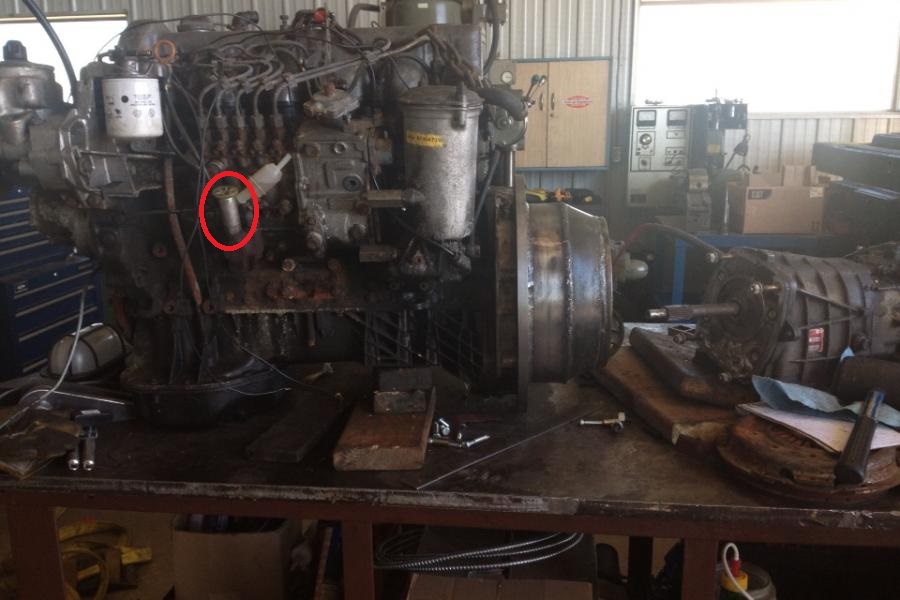

The OM617 engine has a built-in manual primer pump for when it's run dry of fuel. It is located forward of the injection pump on the driver's side of the engine, down in the area below the secondary fuel filter (the big round one). The primary (little) fuel filter makes a 90-degree turn down right into the manual primer pump housing. It is identified by a white round top, about 1.5" diameter. Unscrew that (it takes a bunch of turns) and then start priming by pulling the white round screw top towards the sky. It only has about 1.5" inches of travel. Pump it up and down (a lot of pumps if you ran it out of fuel) until you feel a noticeable change in resistance. When you feel the change in resistance, that means there is fuel to the injection pump and you're ready to start the engine. It should start within just a few seconds of cranking. To speed up the priming process, you can unscrew the large secondary fuel filter and fill it with diesel fuel, but that's not necessary if the pump works. They are a common source of leaks, too, so you might want to replace it soon. If it leaks while pumping, it will still work, it will just take longer to prime.
Attached is a picture of your engine with the manual primer pump circled in red. Good luck.
