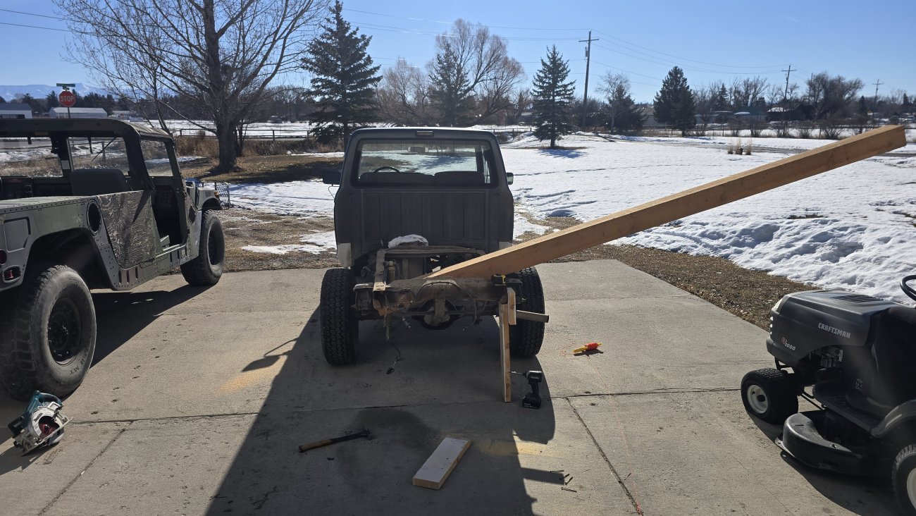

I suppose it's best to close out this thread. I couldn't get the frame to budge no matter how western I got with the massive beam lever setup. So I shimmed the bed and called it good enough. Will need to come up with bumper mounts eventually because it's way crooked.

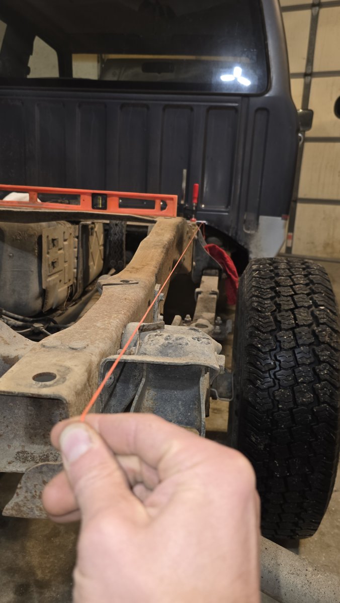

how do the tires look, any indication they are either brand new (from the PO trying to hide the issue) or wear like crazy?
They don't appear to have any crazy wear going on, and the pickup drives straight. I might re attempt to mess with it down the road, but so far I'm into this thing for like $900, can't really justify a frame rack fee. He'll i don't even know if a frame rack exists in my neck of the woods.
I don't blame ya, believe me I've been limping my hooptie '97 Ranger for a while just keeping it good enough for years... if it helps anything the "chain pots" I got for my shop are THESE, they've gone up a LOT since I bought them, it was apparently $221 for the 6 pack when I got them and now it's $388...
For what it's worth, alignment wise the front spring hanger is WAY more important than the rear, the whole axle alignment relies on the front not the back...
