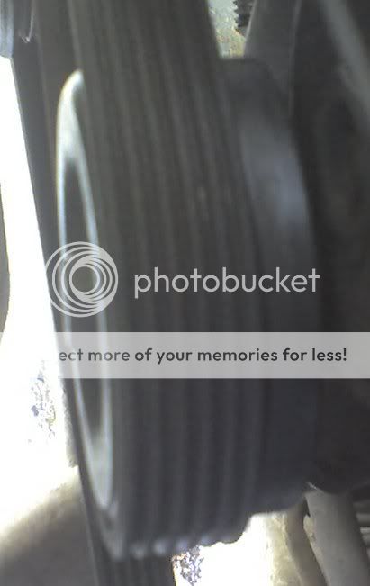

I have the same problem and after NUMEROUS posts and replacement parts, I believe mine is cause by my Tensioner pulley being misaligned. I doubt if you can find it now, but I posted a picture of it a while back and you can see that my belt runs on the far edge of it, likes it's about to slip off.

So Hypno, WHAT caused that tensioner mis-alignment, and what was the fix?
Thanks in advance...
My dad and I are still scratching our heads about how the pulley got like this. But like I've told people before, the person who had this before me DID NOT take care of it. I'm assuming that, because it's still the original Tensioner assembly, that it's just worn. It's been run on 140k+ miles.
When looking at my engine from the top, you can clearly see that my Tensioner pulley is sticking out like sore thumb.
