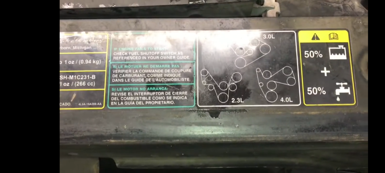

Can you check this? The tensioner pulley should be on the back (smooth) side of the serpentine belt, not on the ribbed side. A diagram showing proper routing should be on a label under the hood, on the radiator bulkhead.
01-12 4.0 rangers. I had to look it up also because I don't think I've come across a tensioner on the rubber side before.

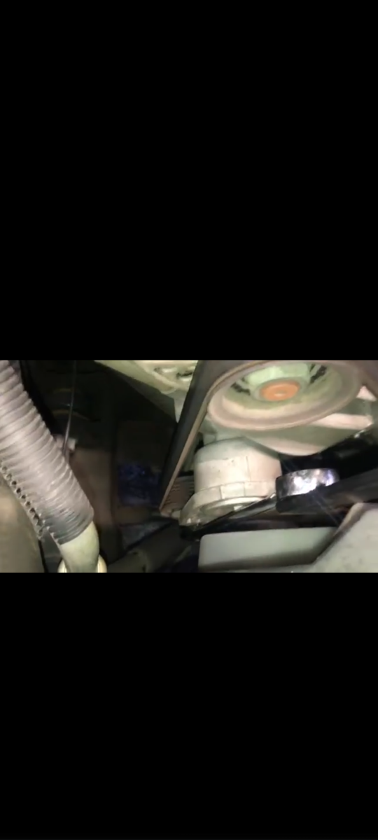

These two idler pulleys are the only possible places the belt could squeal unless you have a foreign object contacting the belt. Even if the bearings are good, if those pulleys are angled at all (bent bracket, washer missing) it'll do what you're talking about, even if it doesn't have the ability to de-belt the system. Try this: color the pulleys with a large tip permanent marker and look for erasure marks. If you see any kind of crosshatching or bare spots, you have likely found the issue. I would say not to idle more than a few seconds, or you could crank it without starting it.
