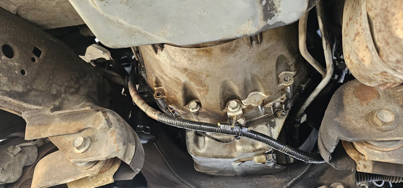

Hey everyone! I see some bolts missing from the bell housing on my 2009 2.3L XL. I went to the yard to grab some replacements but the long ones I pulled are too long and the short ones I pulled are too long. Of course there was not a total match truck that even had a motor / trans in it so I wasn't that confident. Anyone know what these bolt sizes are and if I can order them? Could they be for a puller to remove the trans and are actually not needed? Any Info is helpful!
I'm looking to replace these as I'm trying to locate an oil leak on the passenger side. I figure I'd get these put back in before going to far down the rabbit hole. Many thanks in advance!

look closely, if there are no marks around the hole there never was a bolt head there.
I will have to look at mine, but I think the bolts come in from the front on those 2 holes.
an oil leak on the pass side should be the valve cover if the source is up high. pan gasket if the source is down low.
rear main seal should drip down the middle of the tranny housing.
on the pass side the bolt comes in from the front.
on the driver side the transmission hole isn't even there, never drilled at the factory.
on yours check for a front bolt.
both of those match up with the oil pan, not the block.
