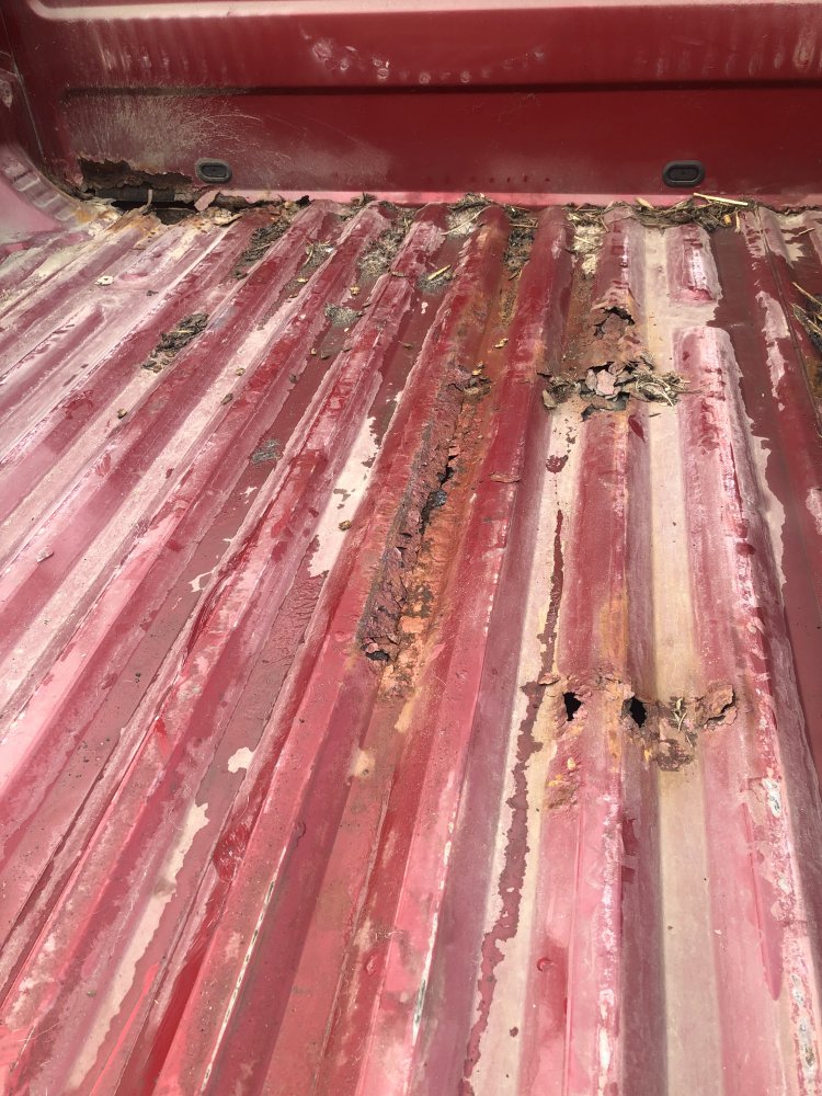

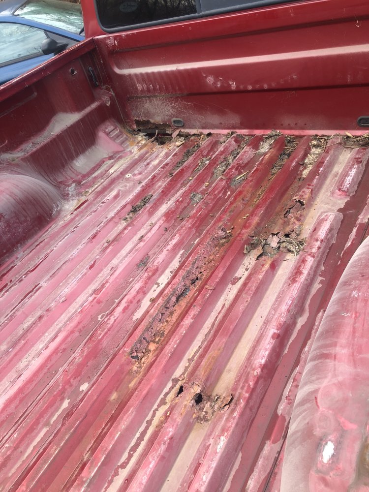

Mine had two of them. I removed them before they caused a problem. PetroleumJunkie's truck was rotted out right where those were glued to the underside of the bed.
This red one 03, and my 11 both have problems with rust there.

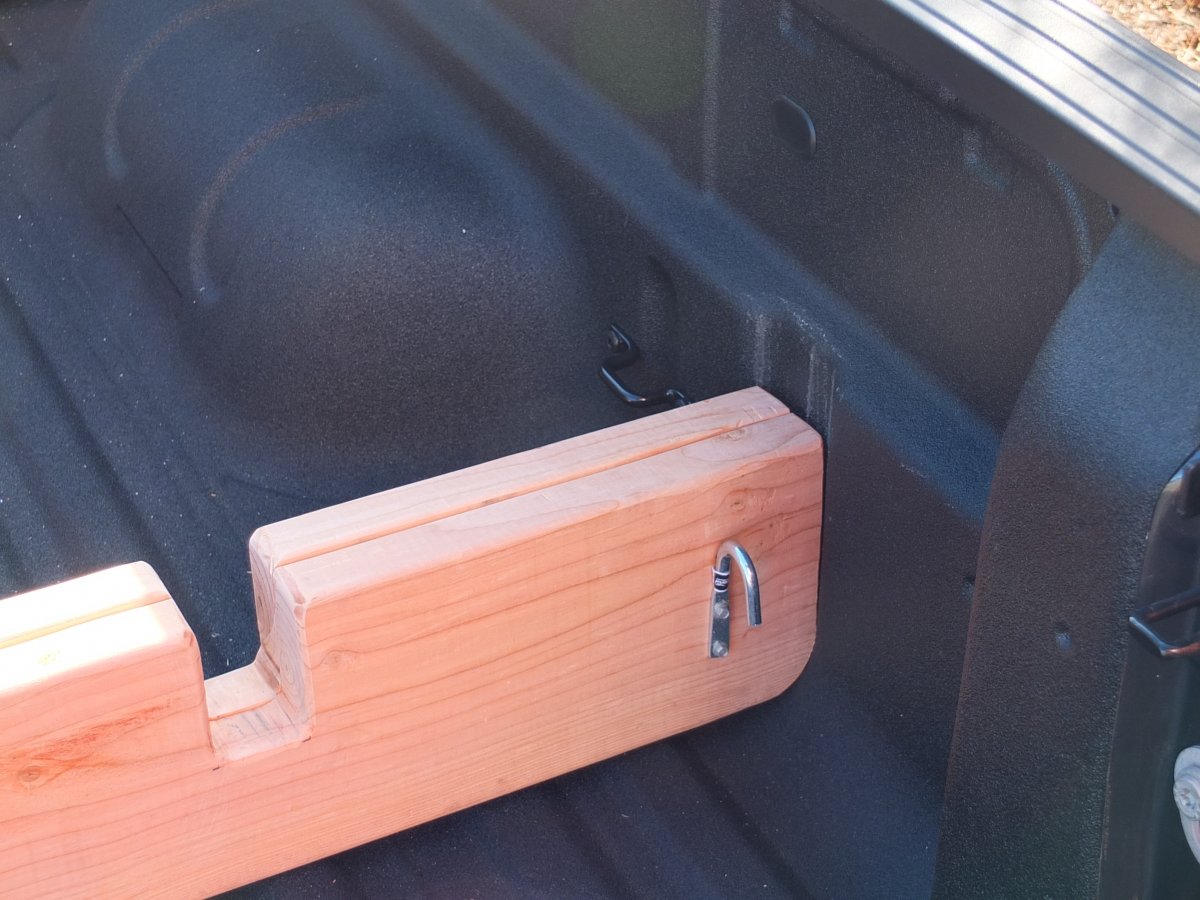

So what I’m thinking right now is that having a cap protect the bed from weather will, for the most part, help keep rust at bay. (the truck will be garage-kept) I just need something to keep the inside of the bed and tailgate from getting all scratched up. So at this point I’m kind of liking 85_Ranger4x4’s idea of considering “both”, a combination of sprayed walls and some sort of bed mat. I’ll have to do a little more internetting to see about different spray-ins and how to protect the tailgate.
Thanks again for all of the responses. This forum is great! I’ll have to take a look to see about those indentations in the bed for 2x’s. I didn’t notice them in my truck.

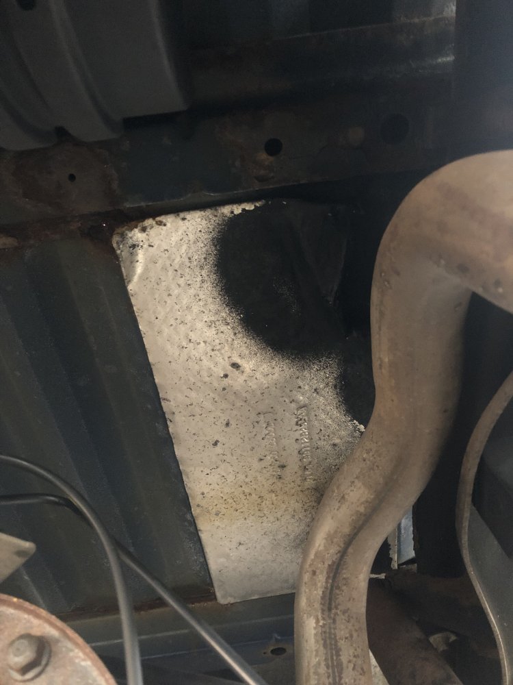

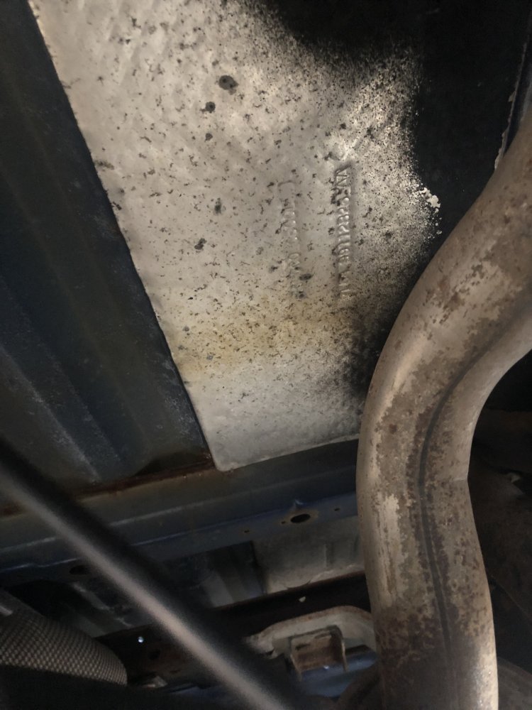

It's like a foam/sponge like pad with aluminum foil on the outside, that's glued to the bottom of the bed. Both my 2011 and 2003 had them there. the bed from the '96 had the regular heat shield with rivets.
It just absorbs water and holds it there.
54224
54225

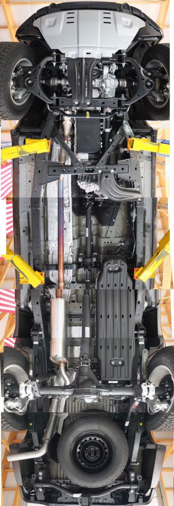

Hmm... I need to check out how those are located and attached on my 2019? There's only about 6 feet of it! :scare:
That's just ignorant attaching them tight up against body panels. Hang the damn things on the freakin' exhaust, not on the body sheet metal.
Looks like the plans were wrinkled when they made your truck.
It's the best I could do, laying on a creeper, taking photo's. I had the creeper in "2L"
