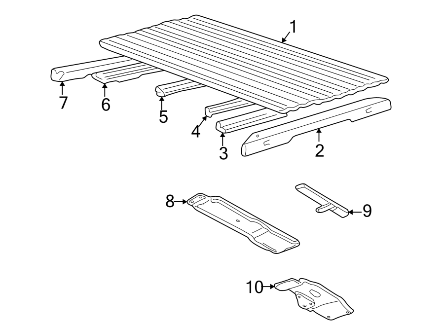

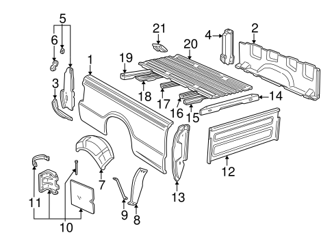

Hello I posted a message for welding bed Cross Member Sill. But was wondering if Mazda B2500-B4000 same for 2000 Ford Ranger xlt 6ft bed. Cause Ford's parts sites have 0 parts but Mazda parts site has all of them. Are they same.
I believe the difference is just the bed skin, crossmembers should be the same.
Seems that the concensus is that it's easier to simply build your own crossmembers or buy some that are too long and cut them. As opposed to trying to locate replacements.
Two photo. One photo Mazda B2500 part I need is number 2 but need all of them cross sill. Two photo is Ford Ranger number 14 which discontinued by Ford and looks same...
