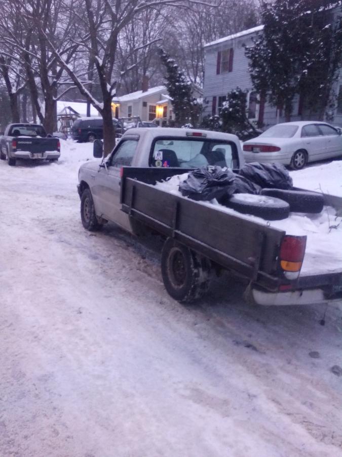

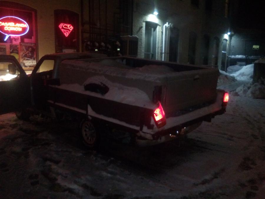

This is what I'm dealing with.

Nice flatbed. Too bad that yucky cold white wet stuff is everywhere.
