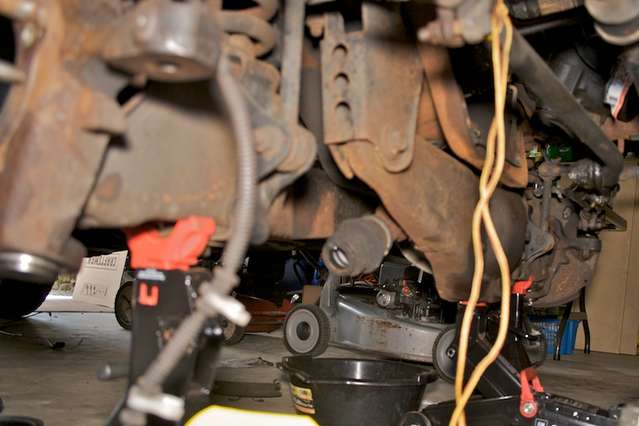

How does the passenger side axle come out. I am planning to replace all balljoints and front u joints this weekend. Ive never had the d35 apart further than the hubs and disks.

The passenger side axle shaft goes into a stub shaft, which goes into the differential. You just need to disconnect the axle shaft from the stub shaft. Cut the clamp on the rubber boot and then you can just pull the axle shaft right out. Here's a picture of the axle shaft removed and the rubber boot on the stub shaft just hanging there:
