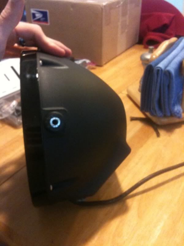

Remove the lights from your vehicle. Then remove the housing assembly from the halo assembly by removing the two adjustment bolts on the side, and the knob on the top.
