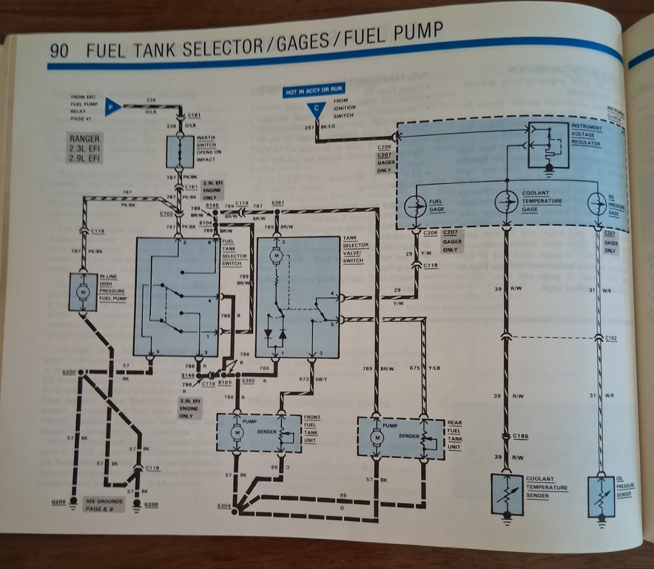

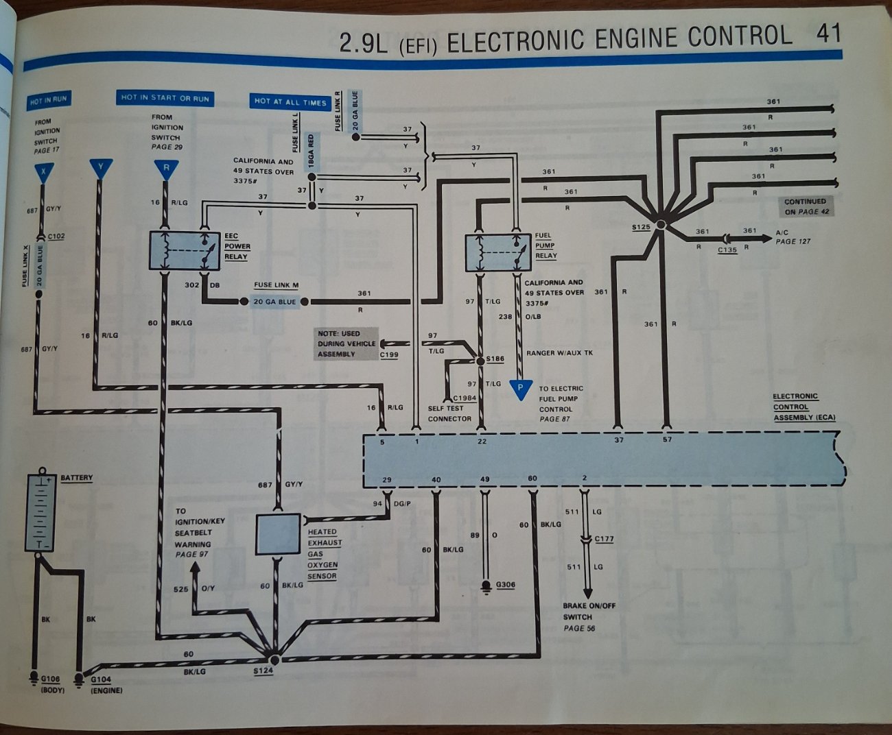

Here are the schematics from my 86 EVTM. They may not be exact to 88 but I think the two pump systems were pretty much carbon copy.

Thanks for posting the diagrams.

So that red wire goes a bunch of places. One is your IAC solenoid. Check the red wire at the IAC connector... with it disconnected. Should be 12 volts...
It also powers all your injectors... should be 12 volts.
If those are the same as the fuel pump reading... refer back to the schematics... there is a fusible link between the EEC relay and the splice that feeds key ON power to all your engine components.

After looking at the schematics I noticed the fusable link as well, where is that roughly?
