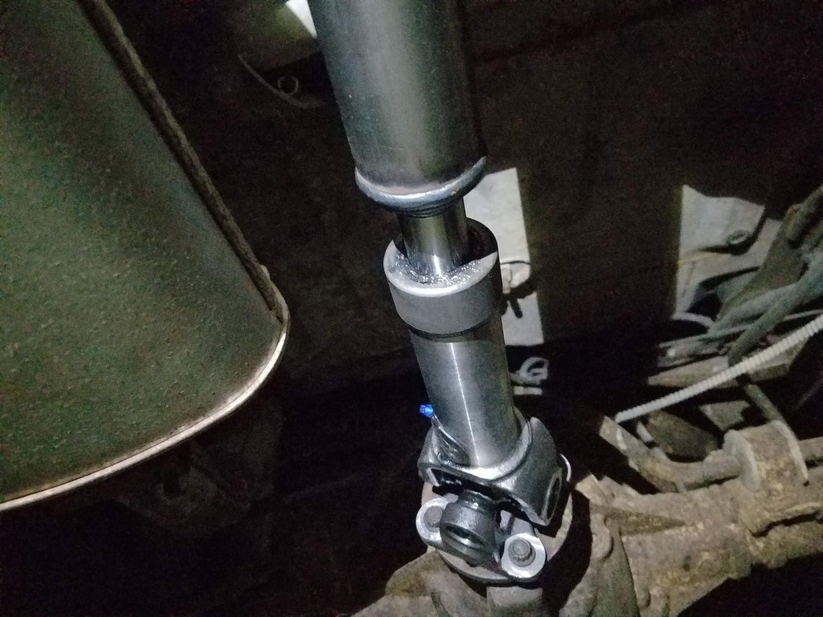

did you clock the drive shaft correctly? i have seen where slip joint was separated and when re assembled was off a couple of teeth on spline cause a vibration .
