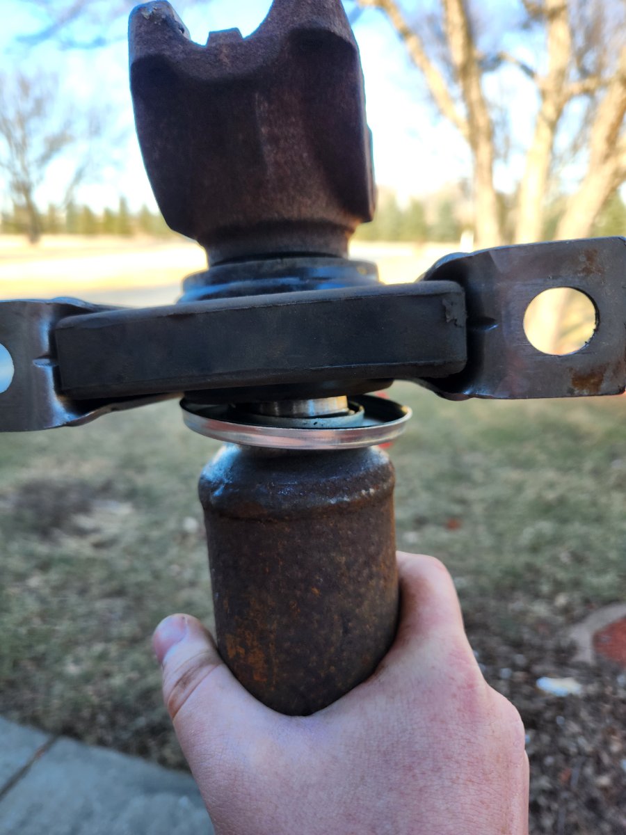

Installing the new carrier bearing, and there is this metal dust shield that is just loose on the bearing. I thought when I torque down the nut it would cinch up. It did not. Is it ok to just leave it loose or do I need to take the bearing back off?
This is what it looks like
  • BAD vibration at low speeds
That definitely does not look correct to me...
How did the old bearing come out? Can you tell if something is different on the new one that is preventing it going together correctly? (or was the old one too messed up to tell?)
Isn't that supposed to be like in the middle of the shaft?
The old one was installed the other way around. I thought if I put it on this way that the fat end of the driveshaft would kinda sandwich it together.
