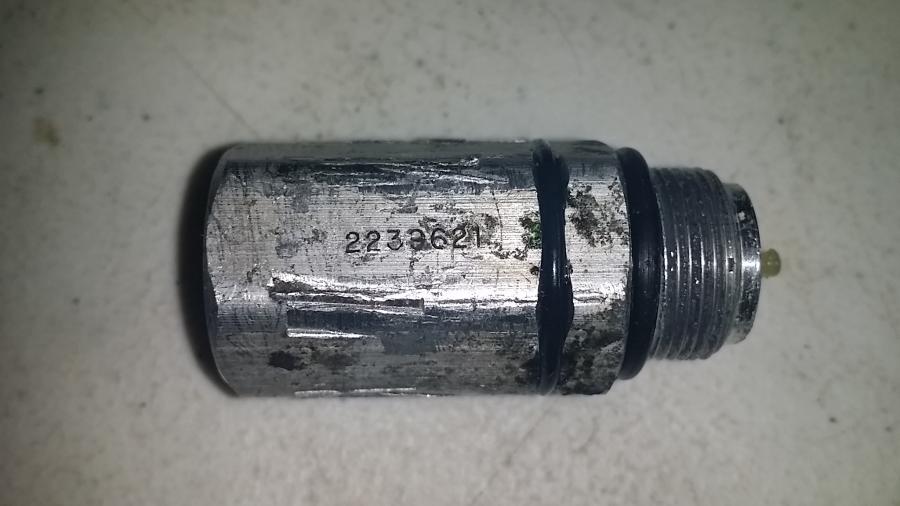

I know this is a super old thread, but I'm having the same problem as the OP. Slow brake fluid leak that has been going on over half a year, I have to top off every week or so. Anyway, I finally found the leak and it is coming from the same valve on the side of the master cylinder that the OP is describing.
A Master Mechanic told me to replace the O-ring, which I did, and the new O-ring basically tore when I tightened it down. I either tightened it too hard, or this application may require a special material. Does anybody know what this part is called so I can, if it is inexpensive enough, just get a new one with a new proper O-ring? The threaded end screws into the side of the master cylinder, and the brake line screws into the other end.
I'm going to try to attach a picture..

Fixed!
I wasn't able to find a name for this part, perhaps "check valve"? Anyway, I put a slightly smaller O-ring on it and installed it again without gorilla tightening it. I pumped the brakes quite a few times and no more leak! I still need to get my wife out there so I can bleed them and I will check again after that, but I think the problem is fixed. It seems this is a pretty common problem, I wish there was a way to make this search come up every time a person with a ranger searches "brake fluid leak". Like many others, I threw parts at the problem. I replaced the master cylinder, both rear wheel cylinders, had multiple people check my brake lines under the truck, and put probably over $100 in brake fluid in during my weekly top offs. All for a ten minute less-than-a-dollar fix. I hope this helps others. Just look at the connection from this valve to the master cylinder for a drip while somebody pumps the brakes while the truck is off.
We saw the brake fluid under the part while checking stuff but everybody just assumed it was spillage from filling the reservoir!
