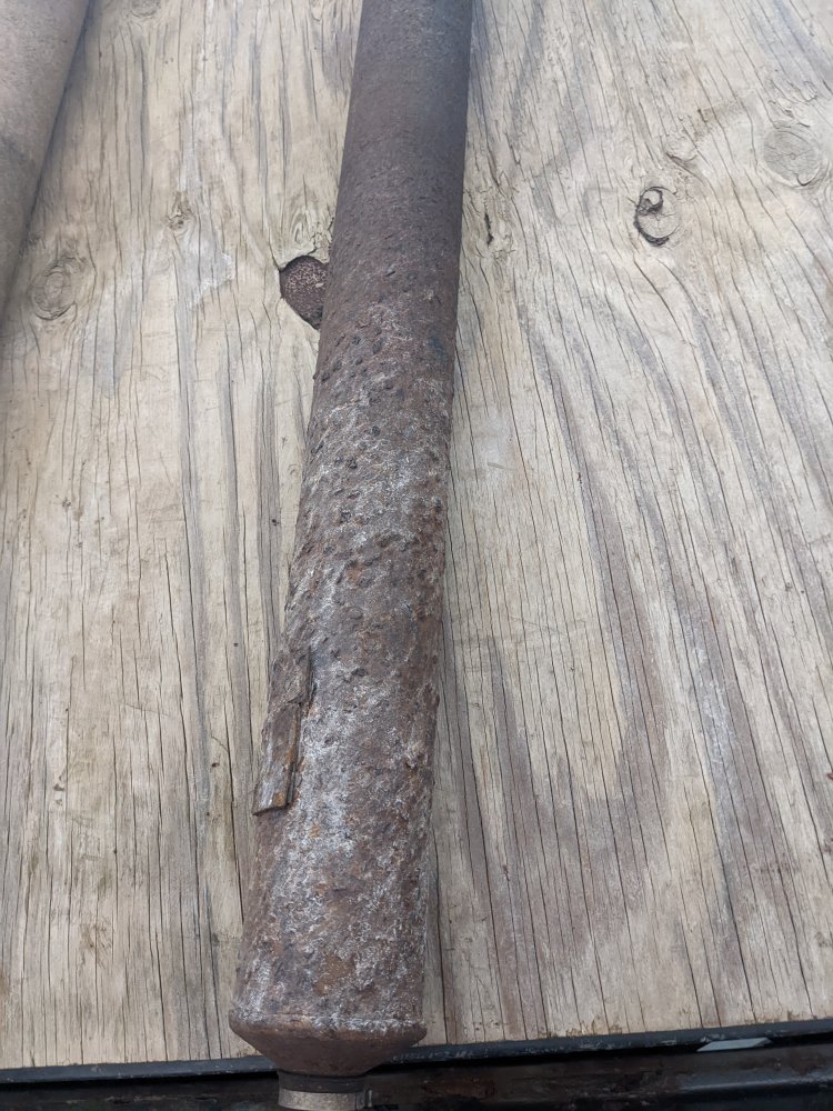

The driveshaft I picked up from the ranger will bolt to the rear end but not the transfer case, mine has a larger bolt pattern. Looks like can change the yokes and should work. I am thinking about doing this as the driveshaft looks to be in a lot better shape than mine.

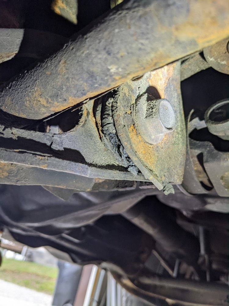

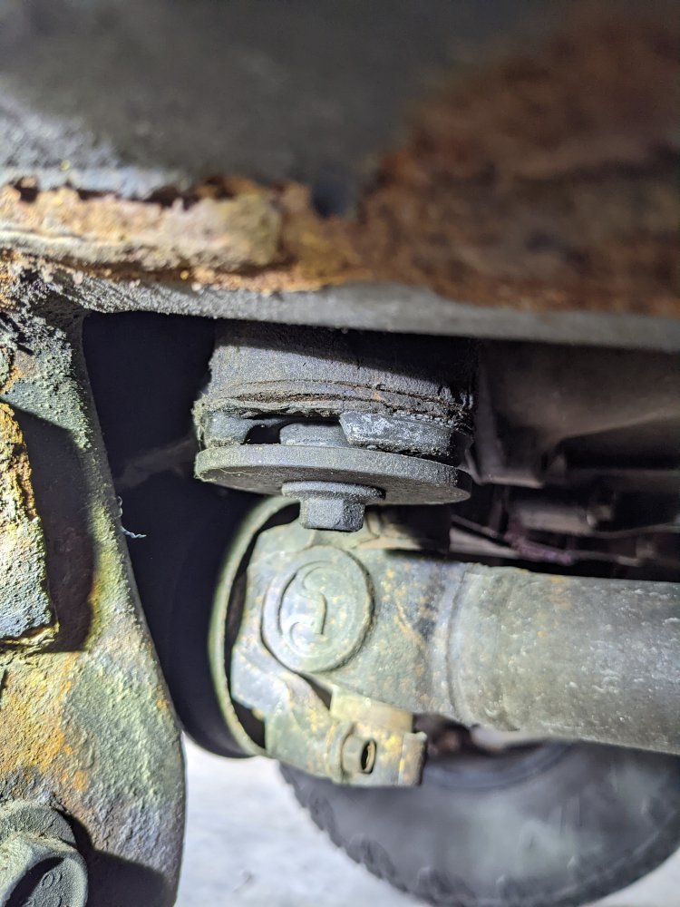

I did notice that the bushings in the lower control arms and on the front differential don't look to be in very good condition, but I wouldn't think this would cause a very consistent shake, would it? I would also think this would cause abnormal tire wire if this was the issue and tire wire is fine.

So did this shake just start or have you had it while? Seeing the bushings, yes they are worn, could they cause the shake? Meh, anything is possible. Have you hit any curbs or potholes hard lately? You said it was in the steering wheel which points to the front suspension and not the drivetrain components.
Reason, you could be experiencing the death wobble. Yes, this is generally a solid axle issue. But, hitting a curb, pothole, or even playing "dukes of hazard" and jumping the truck can affect the caster angle and create a death wobble with worn rear a-arm bushings.
