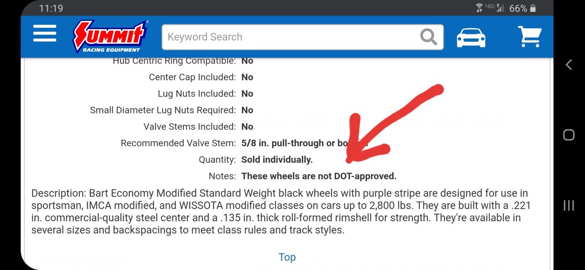

not all of them. it's listed on the overview page as not DOT approved.

It tells you they are illegal to use on the street and lists them specifically for sportsman/modified racing. That should have been more than enough information to know not to try and put them on your truck. Dirt track wheels don't get balanced, you not knowing that isn't BART or summits fault.
