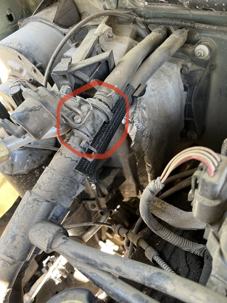

Cracked leaking NotoriousFailureItem JunkPlastic 2WayVacToClose HeaterControlValve,
can be replaced with a new JunkPlastic 2WayVacToClose HeaterControlValve = FordMotorCraft# yg368
or upgraded\improved with a TraditionalMetal 2WayVacToClose HeaterControlValve = FourSeasons# 74603
