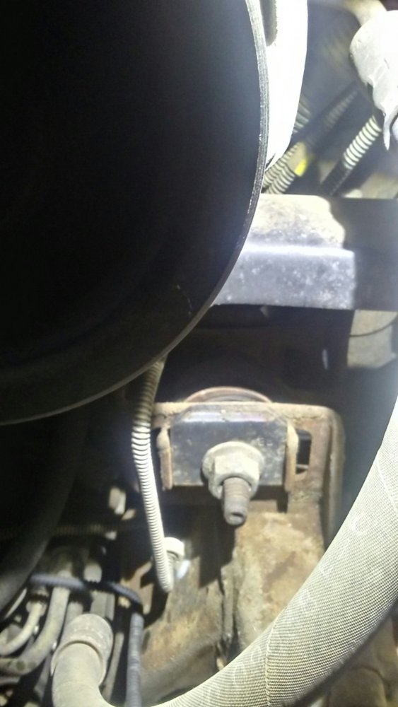

So I've been reading up on the torsion bars, camber kits etc.. It sure looks like mine already has camber adjustment capability, no? Are the kits to adjust it further, or make it easier to adjust? See photo.
