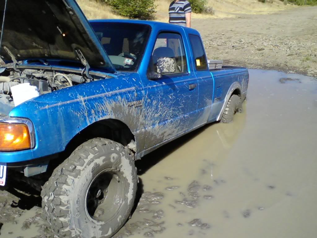

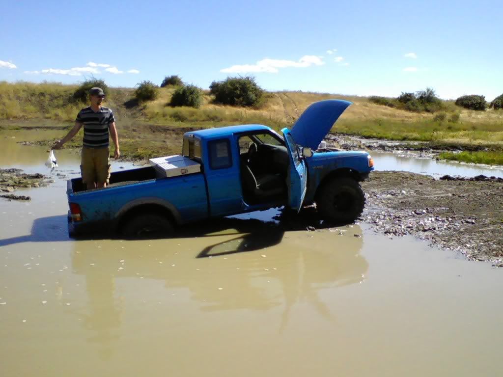

Oh yea and we went on two little gnar hill climbs, failed both ( have about 400 pounds of engine+parts+tools+fluids in the bed, and my clutch and head came banging to the back and knocked down the tailgate. Needless to say I was glad I didn't make my buddy take pics, don't want him getting hurt

And a couple of old ones, from the first hydrolock

Truck is lookin real good that is, with all the mud on it. Glad to hear you got it running good and try not to go into any mud or water holes until your snorkel is put on.

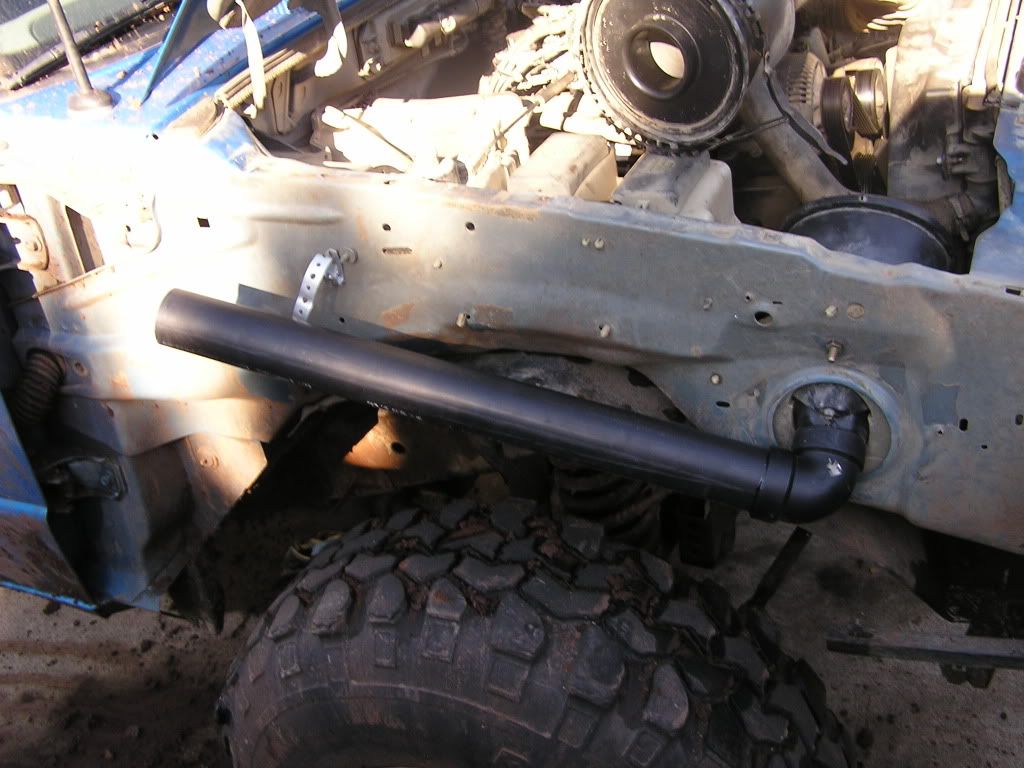

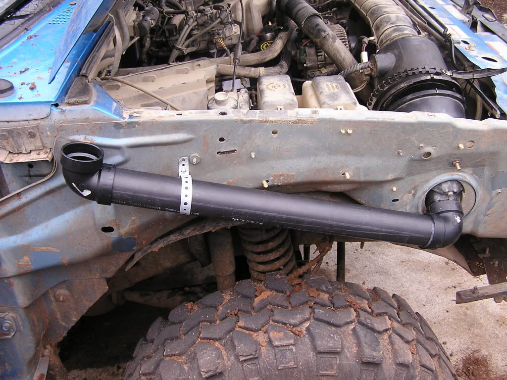

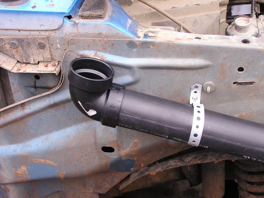

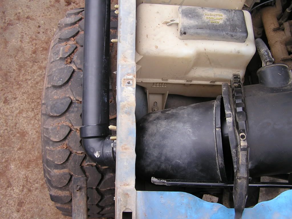

Did some work recently, I rebuild the intake, this is stage one, Im going to build it into a full snorkel once I can either afford an air ram or find another suitable top
Pichers

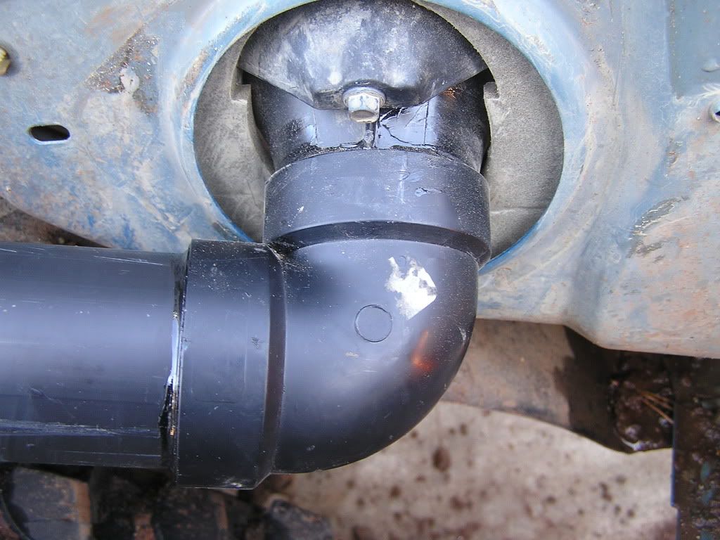

A little bit of sanding and 2in abs fits right over the end of the intake
Fits right up in the pocket at the top of the fender, the 90* turn is pretty tight so I didn't cement it on so when I do the full snorkel I can just turn it then cement it
The whole thing is made outta 2in abs, no loss in power what so ever, and it fits very nice up in there, and its very solid.

nice start on a snorkle :icon_thumby::icon_thumby:

Good looking snorkel, good job!
