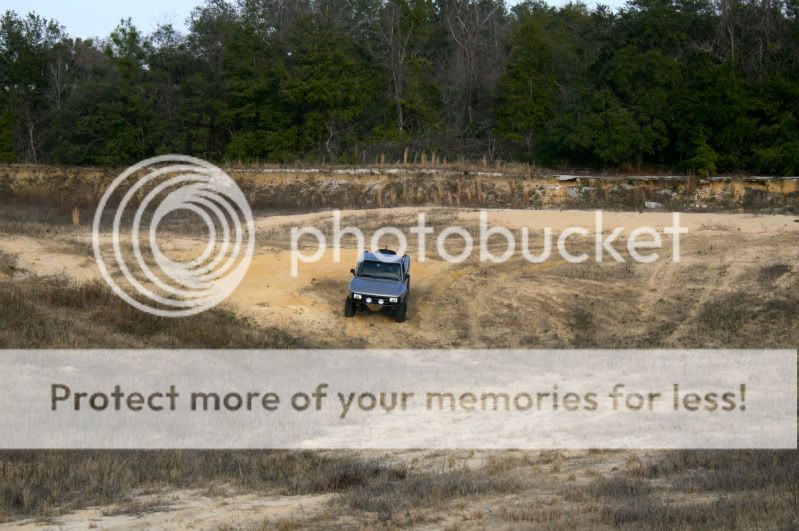

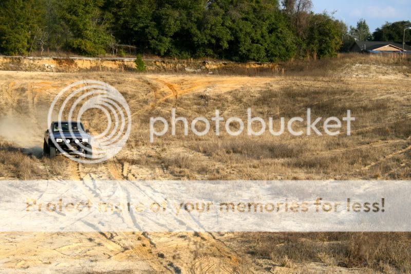

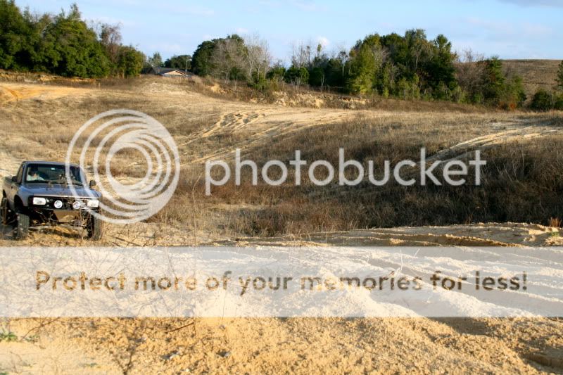

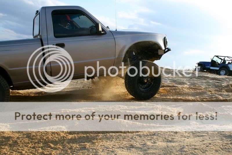

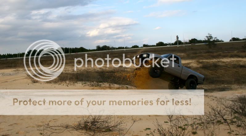

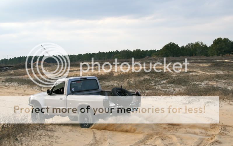

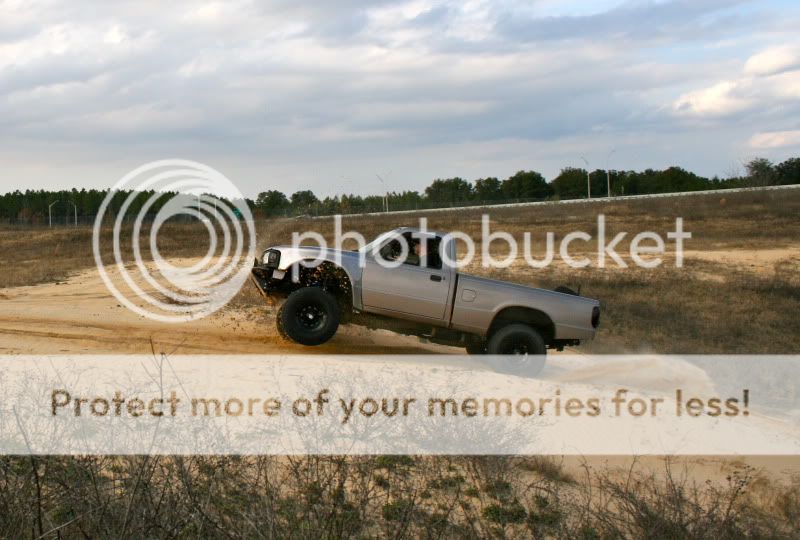

Ok so i went back out to the spot. I was on a mission, to get some part of my truck off the ground. I had my buddy fallow me with his pretty bad ass 4WD Jeep in case i got stuck (i did). My buddy snapped a few pics while we were at it.

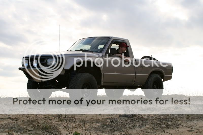

We scoped out a possible jump. It dosent look to big but its pretty steep.
I rolled it just to make sure i had good clearance.

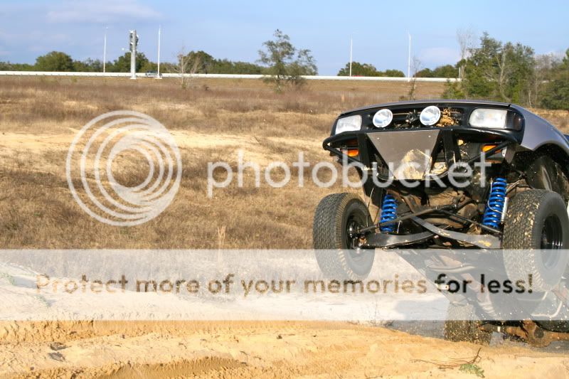

Next i gave it a shot. I went slow just to make sure i didn't plow into it.

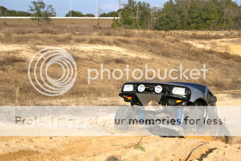

Second attempt. Only 3 wheels of the ground.

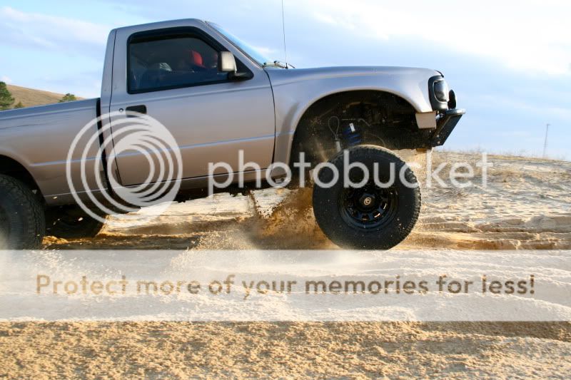

Ok. Here we go. 3rd attempt. All four off.
Some more shots.
Bent my tag some how.
~Shawn

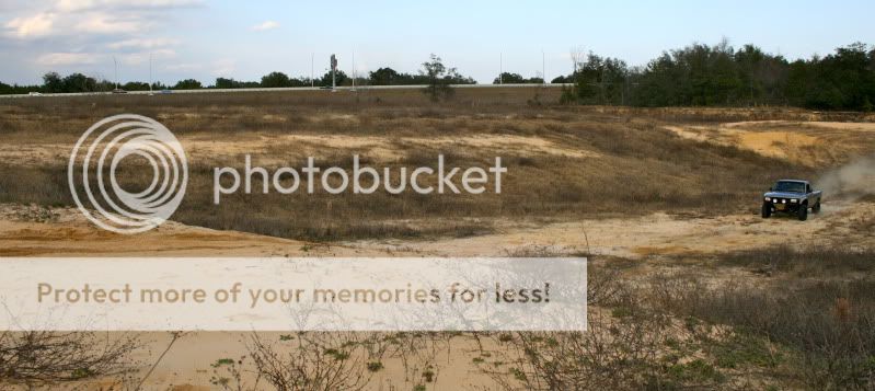

Here is my favorite set of shots. I took my buddy for a ride.
My buddies face is classic....
Over all i had a blast. The truck held up great and i feal way better about the parts i made. Iv never built any off road suspension parts (Beams/coil buckets) and very happy with what i made. There are a few things that im going to do soon. 410's with a LSD, 10" or 12" shocks in the rear (maybe a mini bed cage), F150 leafs with a flipped shackle, extended radius arms, seats/harness's and a few other things. I got a taste of air in a truck, im hooked....

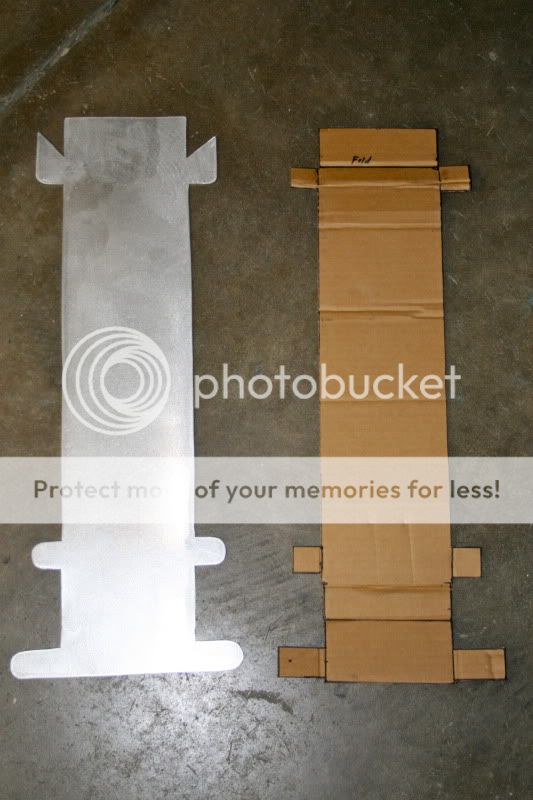

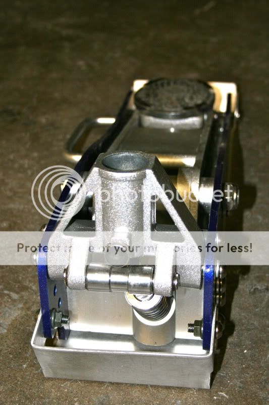

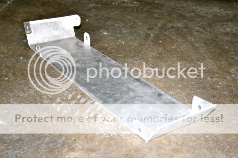

I whipped up a skid plate for my HF jack. Took about an hour and some spare aluminum i used for my skip plate. It was pretty easy, just need to weld the front part of the skid together. If you have a jig saw with a metal blade and a vice you in business...
Made a card board template. Then i copied it to my aluminum sheet. Then cut it out.

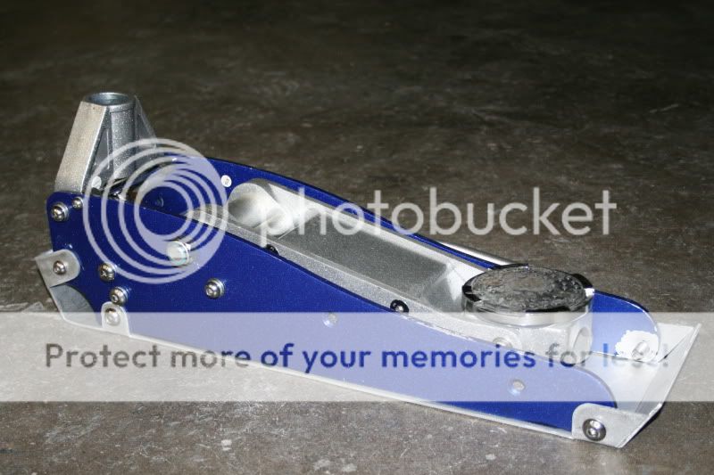

Then i bet it all and drilled out the mounting holes.
Installed. Just need to weld the front corners of the skid and get some nuts for the front bolts.
I know there are a lot of nicer skids out but free is free and came out pretty nice if i say so. Im going to make some lockable mounts in the bed this weekend. I also ordered some quick fists to mount the jack handle. Ill be tackling the F150 leafs and flipping my shackles. If i have time ill be pulling my bed side too.

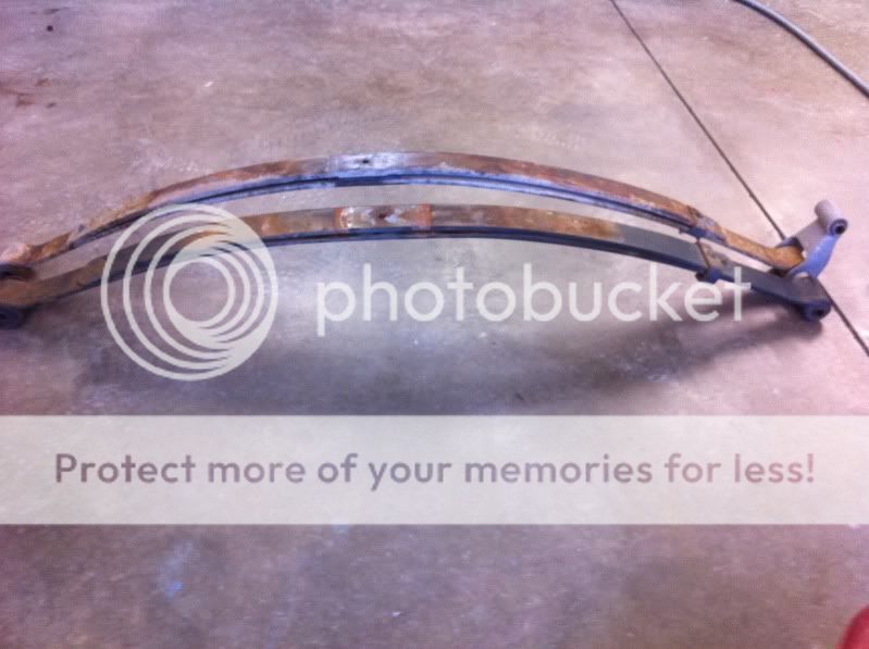

So i first tacked the leaf springs and shackle mount flip. Just a quick over all review and solid facts. I didnt find a whole lot of info on this set up. I was told it would give about 1-2" more lift and a lot more potential for travel. Basically a very mild set up. For now that sounded like what i need. The common Chevy 64" leafs calls for relocating the front leaf hanger and some other things. I wanted to keep it simple as my front end is pretty mild. The F150 (i got mine from a 98 2WD) leafs will add about 3/4" lift with the shackle hanger flipped. I was hoping to get about 1.5" of lift but im just happy its not any lower than it was. I like the low look anyways. Gives it a good stance. So if your looking for a lift this is not for you. If your looking for some extra travel and a simple swap id recommend it. I dont have any solid numbers as my 8" fox shocks are limiting the travel alot but with some 12"-14" shocks i think i could really benefit. On to it...

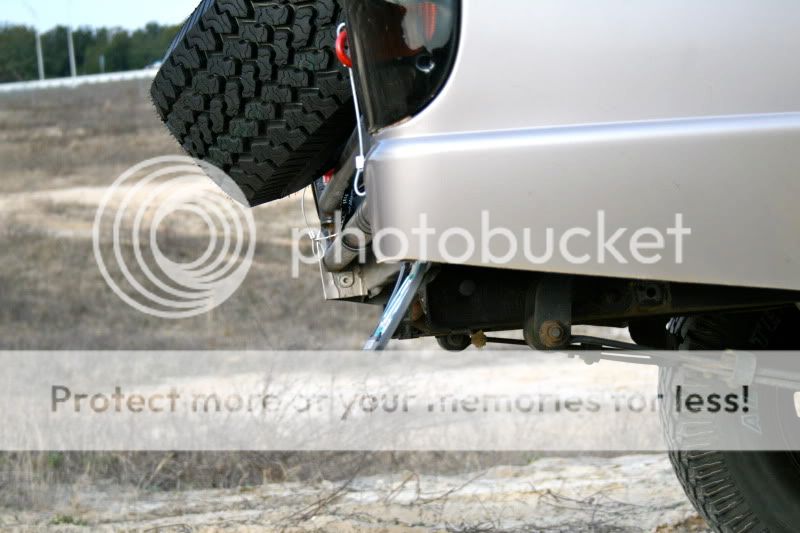

Here is a pic os the Ranger and F150 (back spring). The F150 spring has a higher arc as you can see. The F150 spring (eye to eye) is about 1" longer from the centering pin to the rear bushing than the Ranger spring. Keep that in mind for later.

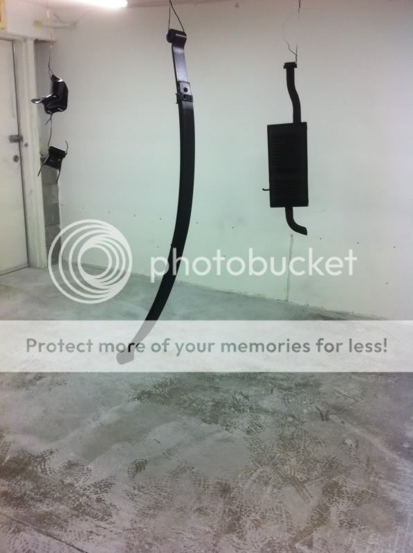

I took the over load spring out of the F150 pack and painted all the suspension parts with some industrial black paint. Looks clean and should hold up pretty good. I sprayed (spray paint) the cat back with some high temp black while i was in the booth.

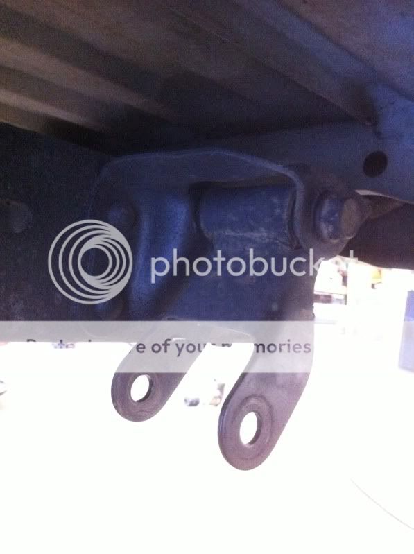

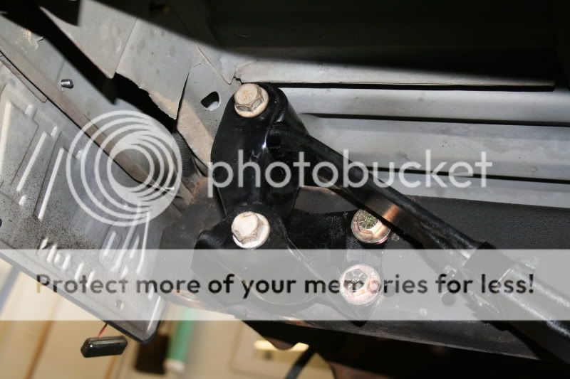

I know this is very basic stuff but for you guys who might not know or are confused on flipping your shackle. Below is a pic of the mount in OEM position.

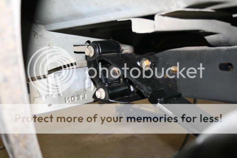

The front of the leafs was just bolting it in like stock. The rear shackle mount was a fun task. Once i removed the rivets that held it on i cleaned up the frame. Because the F150 leaf pack is 1" longer from the centering pin back the mount needs to be moved 1" back. So i drilled 4 new holes 1" back (towards the rear of the frame). I used grade 8 1/2" bolts. The nbolt on the shackle and then bolt on the leaf pack. Pretty easy. I noticed when the suspension was under compression the shackles rubbed the back of the bed. This is not to be confused with the top as the chevy 64" leaf sway need you to cut into the top of the bed. Just some of the sheet metal need to be removed. Here it is installed. Over all a pretty easy job with good benefits. The truck ride pretty well. Better than before and is WAy better off road.

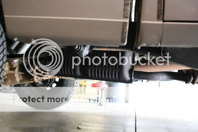

Last time i was play'n with the truck off road, my exhaust may have got knocked funny and has been rattling. I had it cut so it dumped just past the axle. Iv been wanting to dump my exhaust after the muffler. So i cut the bend the turns up just past the muffler and rotated it down and re-welded it. I like it a lot as it looks clean and sounds stock. Not more rattle!

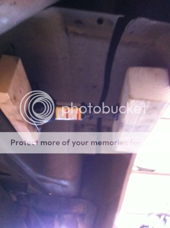

First i cut the inner bed support down the middle. Then i placed the jack between a 2X4 and a 4X4. Then just jack it out till you have enough clearance. I pulled mine 1 3/4".

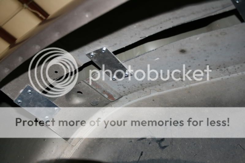

Im kinda pissed off, but i went to the metal shop and bought some thin aluminum sheet for this but i forgot it. I had already cut my bed so i figured id make due. So i just cut some aluminum plated and used some self tapping screws to hold it. It works fine but ill go back and make it cleaner.

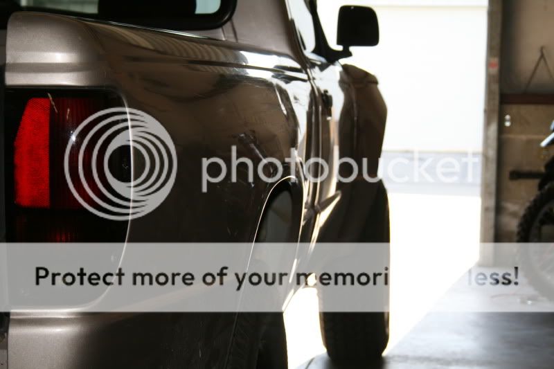

Can you give us a more overall pic of the truck with the pulled bedside? I'm really curious how it looks.
Ill get some pics for ya. Its nothing crazy.
~Shawn
Thanks man^.
