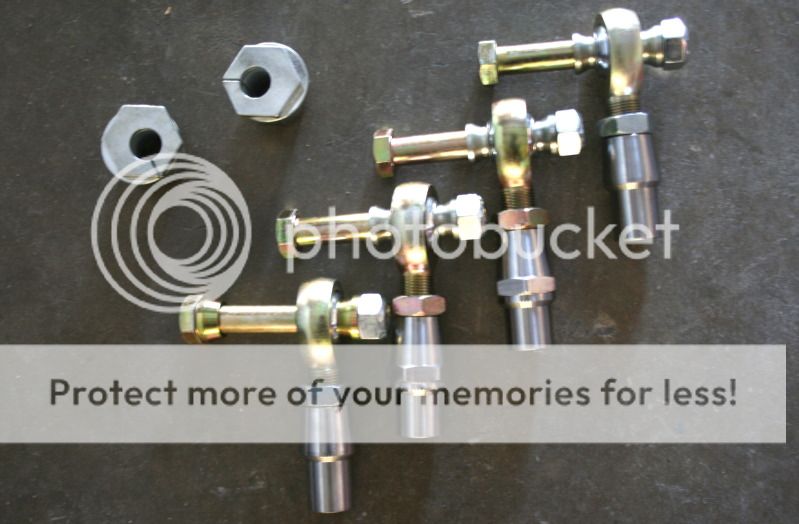

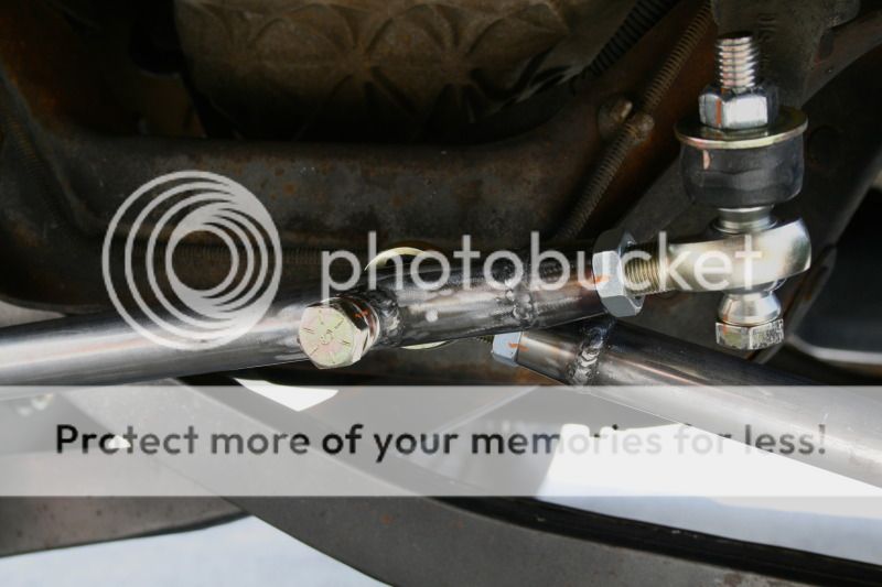

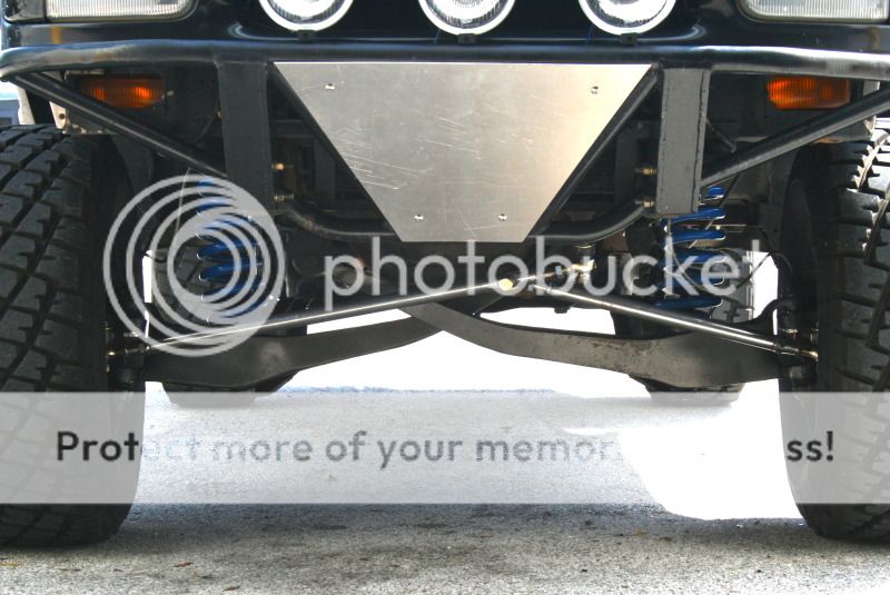

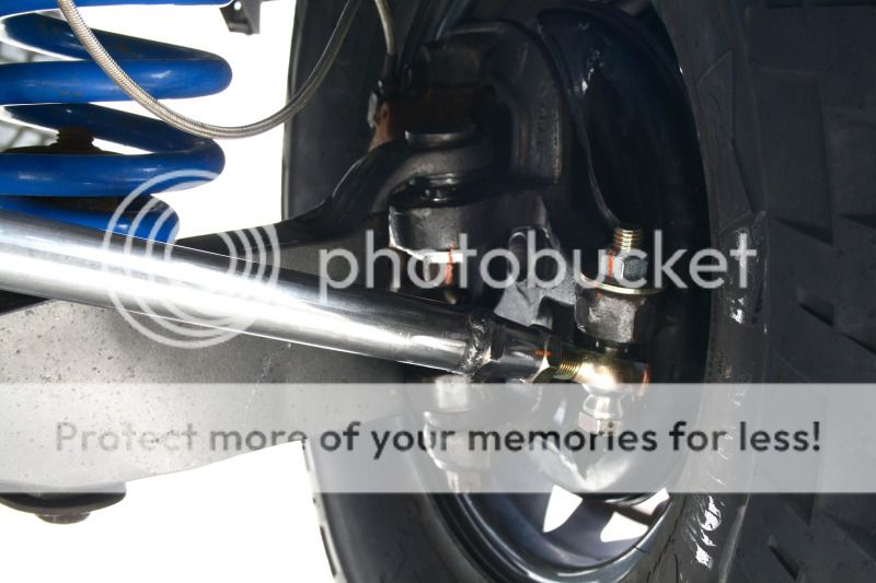

Well i finally got around to building my steering. I went with a stock heim set up. The steering is so much tighter than before. The steering cost me about $150. I think it was a good bang for buck. I used 3/4 heims with 33deg high alignments reduced to 5/8. I drilled out my pitman arm and spindles 5/8". And used 5/8" grade 8 hardware with locking nuts. I used 1.25" 120 wall tubing with weld in right and left hand bungs. Over all a pretty easy task. I also installed my much needed camber kit.

"Why didn't you mount the tie rods [terminology] above the spindle arms?"
To be honest i did a lot of research on single swing and stock style heim steering and iv always seen it mounted on the bottom. For what reason i have no idea. Seems to work well though.
