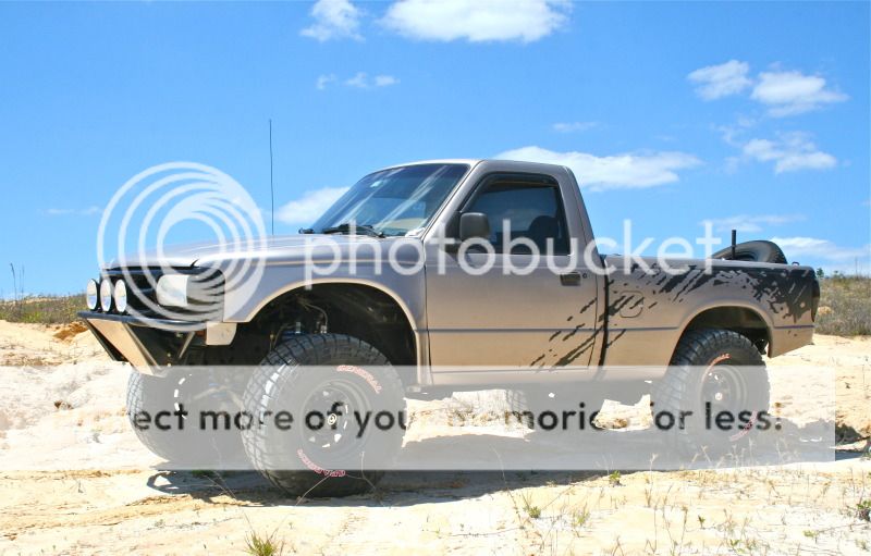

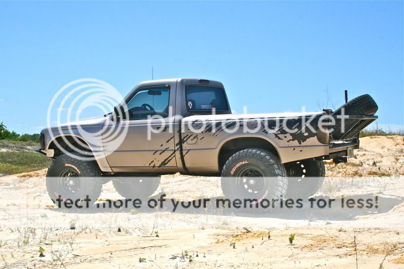

Finally some updates!
About a month ago a lady pulled out in front of me and i ran in to her. Good ol Florida no fault so it was on me to fix my truck. He she was driving a Niassn Rouge. I actually drove on to the car. Lets just day Rouge 0 Mazda 1 . Totaled here car out. I ended up breaking one of my fog lights, broke my grill and dented my hood.

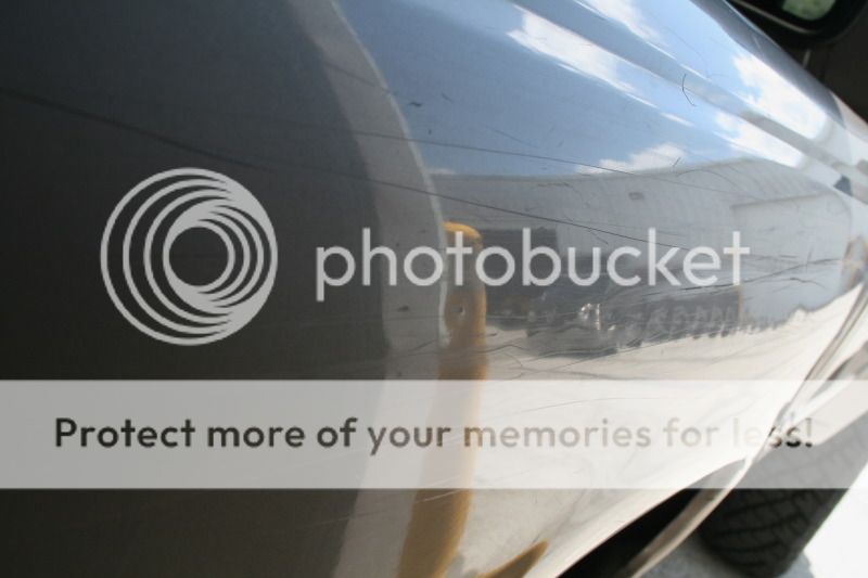

So i got re-inspired with my truck. I bought new 33" Grabbers, new set of Hellas, new grill and a new hood (i haven't painted it yet). One of my sponsors for Supermoto racing dose all my graphics for my bikes/trailer and i kicked the idea to him for some matte black raptor style graphics. The main reason is my passenger side bed is all messed up. When i got the truck the body was really good except that bed side. It just has scrapes all down the bed. SO i figured the graphics would cover most of it up (and did). Hopefully i wont get to much flack for it..... I want bed sides but they cost more to ship to Florida than they actual bed sides.
Before:
B3200 PreRunner Build.
Sense i had 1 good fog light i bought 2. Iv been wanting to have 3 total. I think im going to add a hoop over top of the fog lights. Adding 1 more light made such a difference.
I think the graphics look good. Hopefully its not to "Bro" as you west coat guys say.
