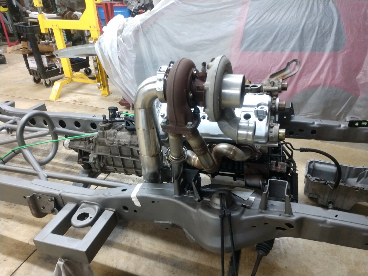

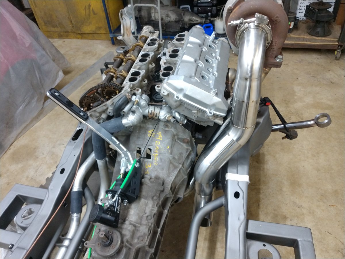

Self explanatory.

I've never looked into the drifter builds... so the single handle Wilwood brake master cylinder makes me go... hmmmmm
I've used single handle steering brakes many times... but they push pull and have two masters... one for each wheel.
Nice work on the plumbing and exhaust.
Holy turbo plumbin tubing, Batman! :eek:
(y) in case it's not obvious, the hand brake will activate a second set of rear calipers that area independent from the oe calipers and factory parking brake.

I made the brackets to secure the radiator lines to the frame. I was putting it off and finally got it done. I also shortened the height of the tubes coming out of the bed. I was planning on putting the radiator across the down tubes of the cage but I think I'm going to lay it flat across the rear end instead.
I spent most of the they modifying the tranny crossmember. I wasn't planning on doing this at all. I started installing the main brake line down the driver side frame rail and ran in to an issue where the tranny crossmember bolts were going to be pushing against the brake line. That's no bueno. I'm not really thrilled how it turned out, but it's fine for now, and when I put a t56 or gforce in it later I can remake it to look better. Remaking it does help me out in other ways though. It gives me a lot more clearance to run the exhaust, which was shaping up to be pretty difficult. It also lets me service the radiator tubes without having to pull the crossmember. That's good, I guess.

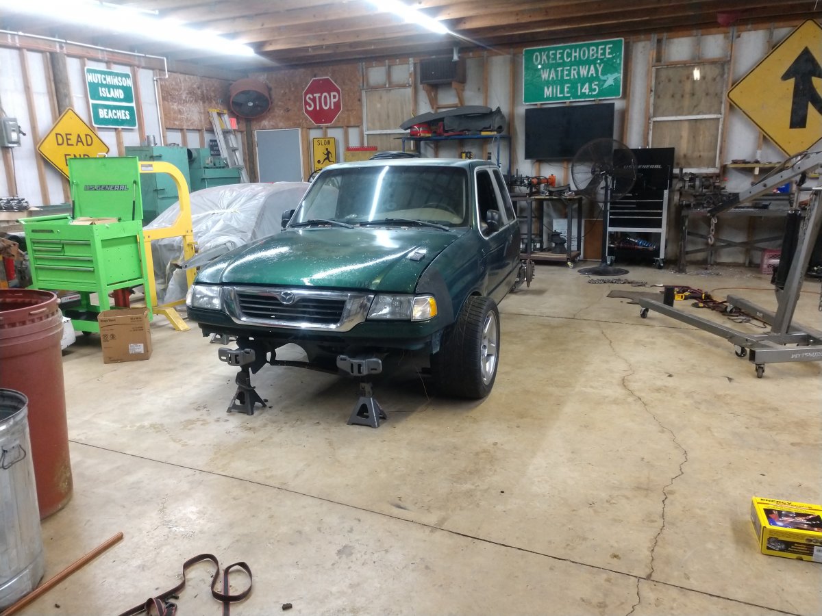

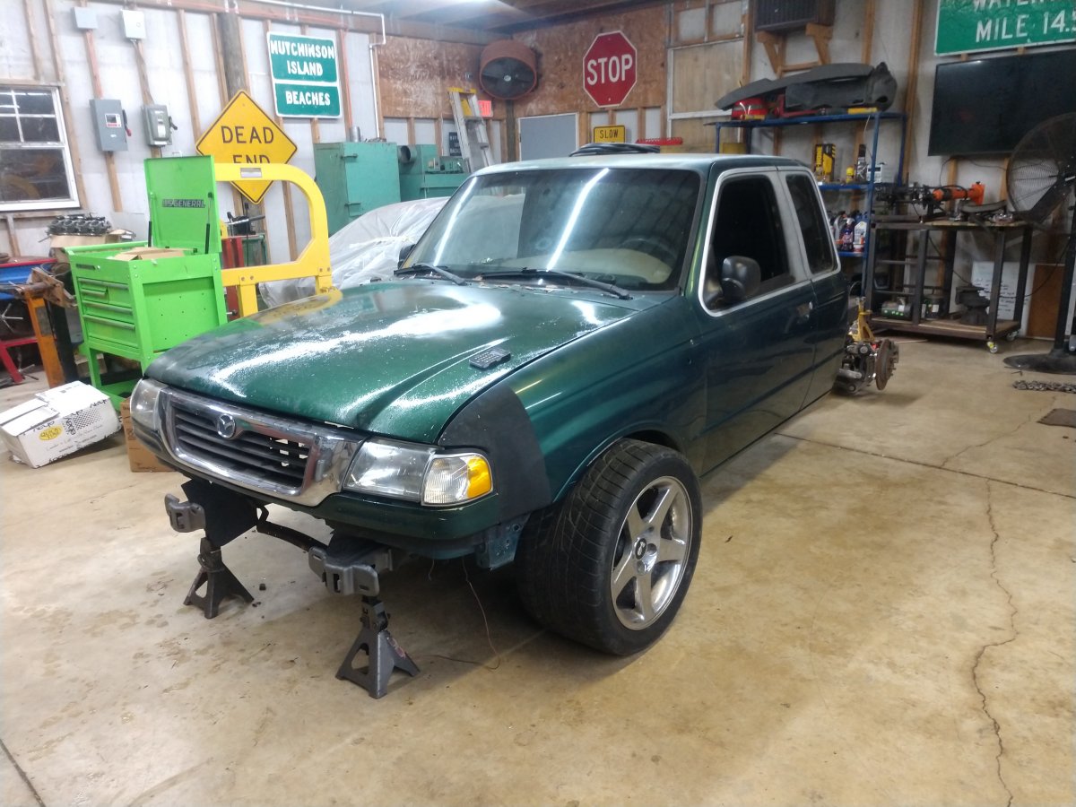

Last little bit of work for a while, as my traveling work season is kicking off. I finally got the cab back on the frame, for the time being. It will come off once more too do a final clean up on frame, mount the front a-arms and shocks, and undercoat the bottom of the cab.
I ordered a set of energy suspension cab bushings. I stupidly tossed the stock bushings. Well the truck sat too high for my tastes. I'm not looking to lay frame or slam it, but it didn't look muscley enough. I'm going to have to mod the spindles, but I'm going to lower the frame 1.75" below where I originally was planning on having it. I also machined solid cab mounts out of delrin that drop the cab on the body by another inch. The body needs a little clearanceing underneath for the 1" cab drop, but not a lot. Very very minor compared to a body drop.
The attached pictures are before the cab drop. I'm still waiting for the wheels to come in..... I ended up ordering rpf1's. 18x10.5 et15. I think I'm going to have them painted white. That usually looks good with a green body. The wheel in the picture is set at the expected track width. It looks like I'll be making wide body fenders after all.
