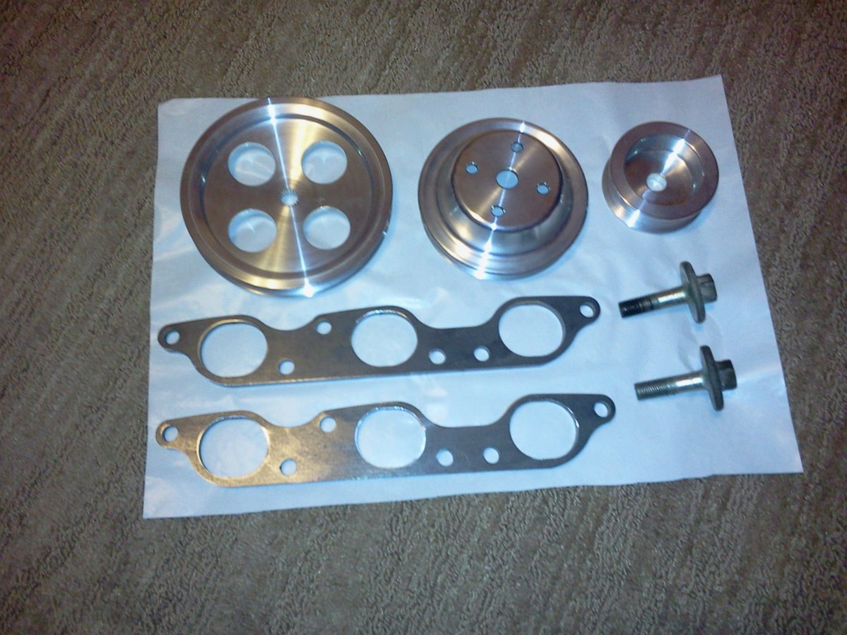

By the way, turbo headers didn't show up. USPS delayed. So All I've gotten done is get the intake cleaned up and painted. New gaskets for the intake won't be in for a couple days, so I might loose bolt it together but right now it's a a waiting game. I'm also waiting on ARP flywheel and pressureplate bolts. I'm trying to track down a good quality harmonic damper bolt, but ARP doesn't offer anything in a close enough size to use. I'm also looking for underdrive pulleys so I can spin the motor to 8500rpm. I found one company that still sells them, but at $300 a set, it's probably going to wait for a bit. I'm also waiting on some intake manifold spacers. I want to bump the intake up 1/2 inch to clear the timing cover. But I need to get a gasket to the waterjet guy before he even starts that. And I need to get him to re-cut the thermostat water neck as I gave him bad dimensions on the first one.

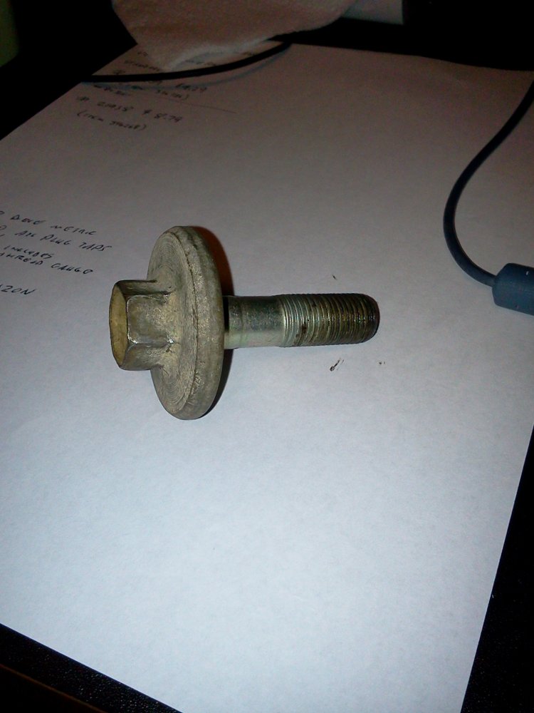

the SHO harmonic balancer bolt is almost impossible to break. the only issue I ever heard was rounding it off because of cheap tools.
they can be really stuck on.
they are 14mm x 1.5 x 50mm. the flange is 45mm wide. head is 19mm.
35635
Yeah I wouldn't even consider changing it out if it weren't for the fact that the motor I picked up doesn't have one an I'm pretty sure they're unobtanium now, short of pulling one from another motor at a junkyard (which I bought the only ATX within 200 miles of me)
MTX/ 3.0 and ATX/ 3.2 use the same harmonic balancer bolt.
the mighty 3.0 Vulcan has the same 14 x 1.5mm threads, but it's too short.
maybe some other engines have a similar bolt.
I'll agree that parts are getting hard to find for the Yamaha V6 SHO engines.
