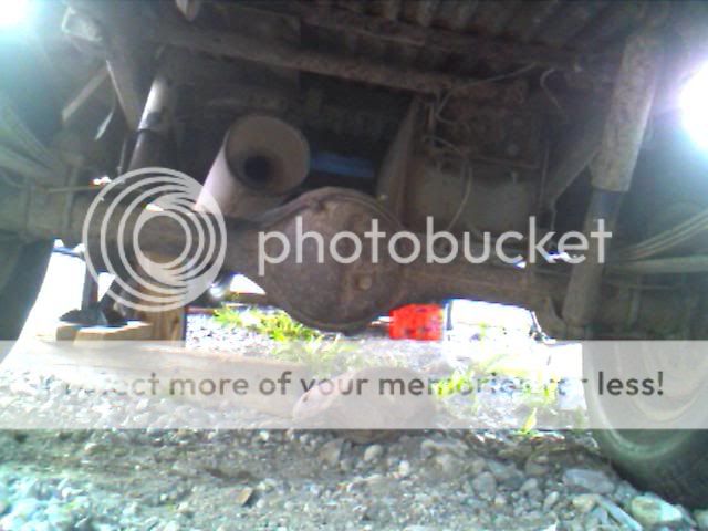

could somebody on here tell me what the axles are on my 1993 mazda b2600i {pre-ranger years} shes a 4x4 and i think the rear is a Dana35 just wondering what the front is, thanks:icon_cheers:
is it just me or does my rear axle look like its one solid peice?
axle pic ID
thats whats under my 93 B2600i {pre-ranger}
it seems to be the queerest axle ive ever seen, no bolts on diff cover, maybe its pressure fit or something?
could someone please help me? thanks
It's a front loading axle, like a ford 9". The bolts that hold the third member (the carrier assembly) are on the front of the housing.
It doesn't have a diff cover, it has a removable center section... I have no clue what it is, but it reminds me of a rear axle put under the Nissan hardbody trucks of the early 90's...
thanks guys and most likely it is something like the nissans
