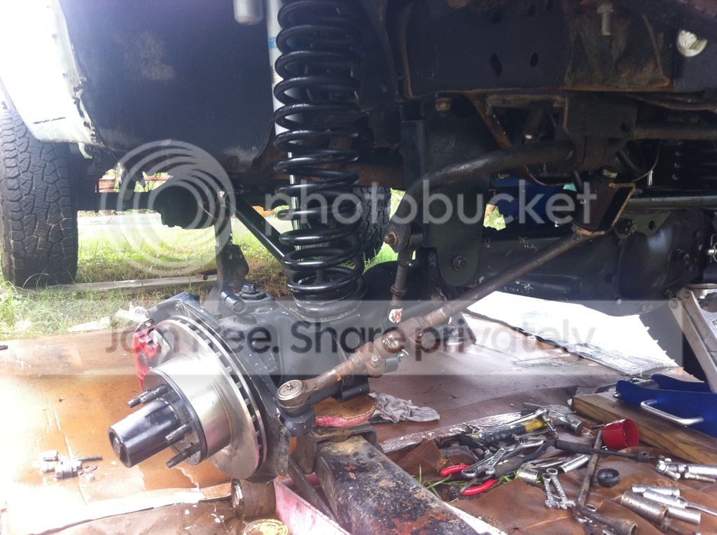

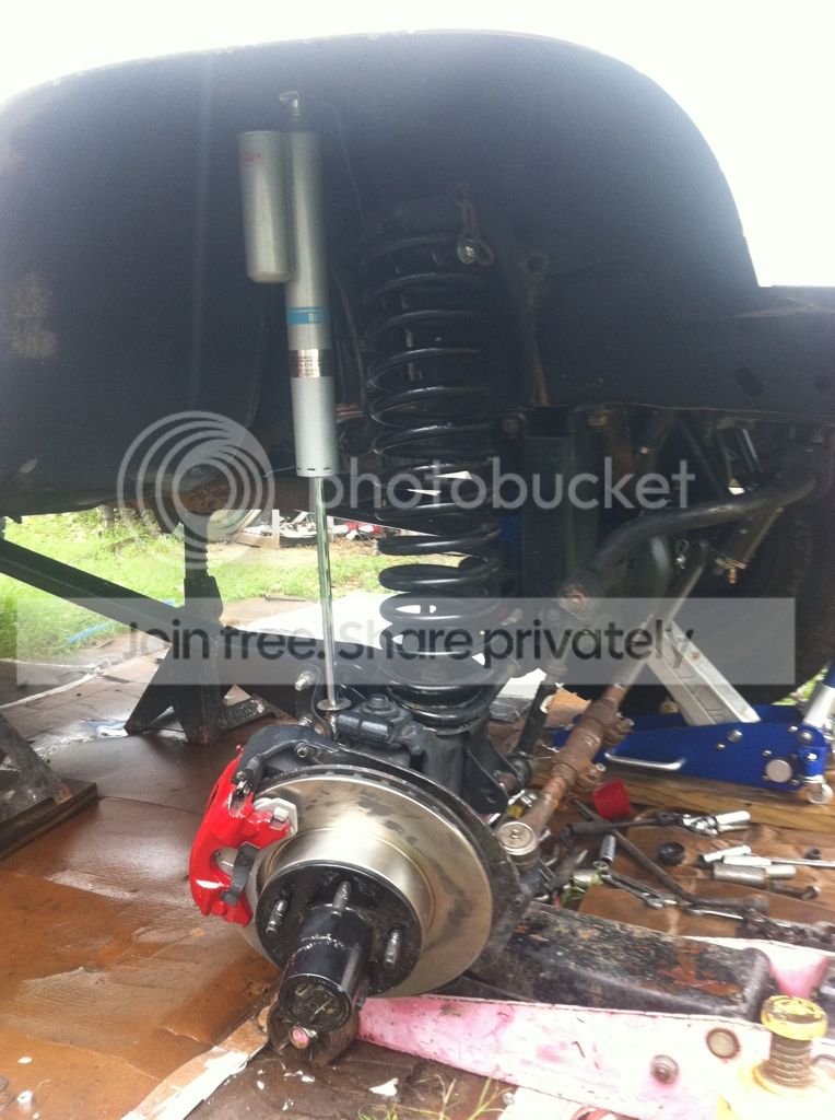

You can kinda see mine here

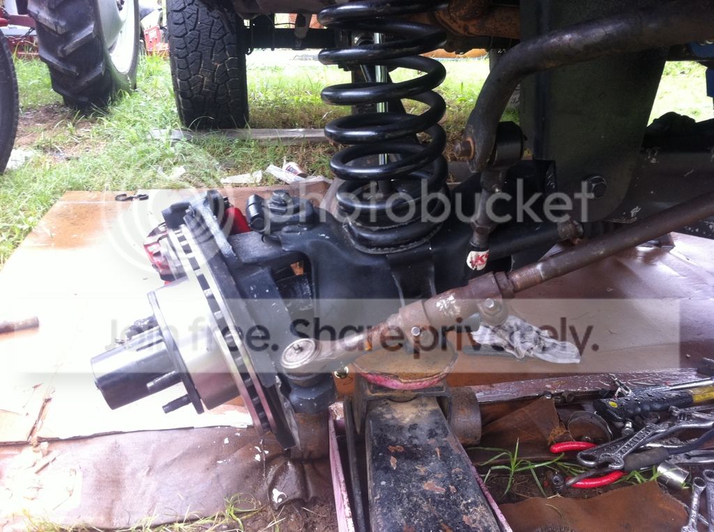

then this is what happens when you try to use coils to long for your drop brackets...
that helps alot im more visual learner than anything and the coils haha i died how long were your brackets
Those were 4" brackets with coils that have me 7" of lift.
