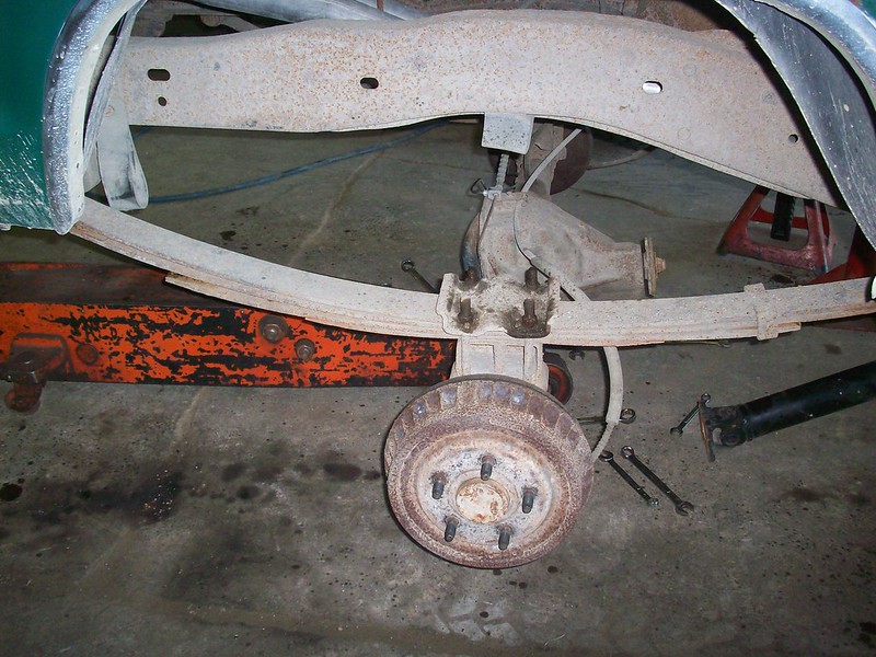

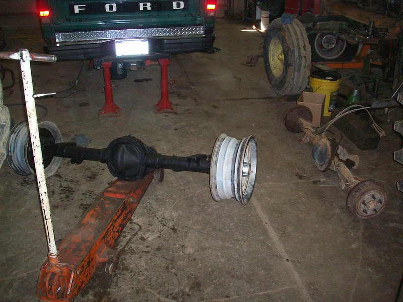

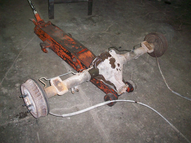

I did my axle swap-out with the bed off, truck was backed into the barn and I used a overhead hoist to hold up the back end. Rolled old axle out then “new” axle under. Had plain 14” wheels/tires on both axles. Used a floor jack one side at a time to raise axle to the spring pack. Having the bed off made things easier. (brake lines, drive shaft, shocks) Didnt pull bed just for the axle swap, needed to repair rusted frame and had a better bed to put back on, in fact it had no bed when I drove to pick up the new axle, I just threw a sheet of plywood on the frame with some eyebolts to hold plywood and give me a strap tie down. Not a flatbed fan but it worked.
