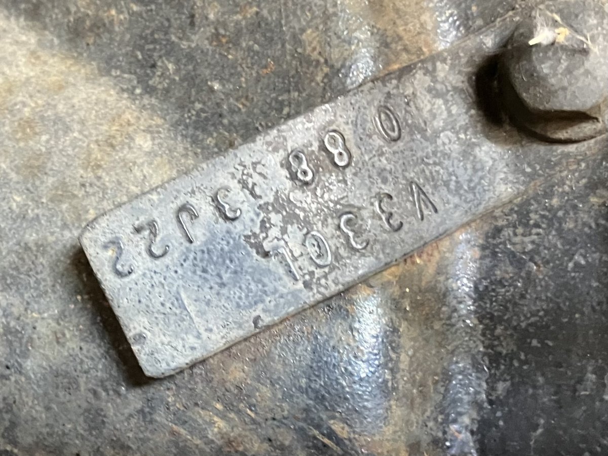

I found that the original 7.5 was swapped for an 8.8. How do you read this doff tag that’s on it. I need to know if it has an LSD and the number of splines. Heck, I don’t even know if it’s from another Ranger or a Mustang.

here is a site with codes, scroll down to see that V series is on their page 17
the tag will not show splines, unless you look up the model #
the ratios are listed as 4.10, that is a normal open diff, 4L10 would mean it's a locker
8.8 is ring gear bolt circle
there is a number before the 8.8 denoting ratio, ;it's not visible on yours.
3J22 is a date of mfg
V330l is the model #,, S means mfg'd at Sterling plant, most axles are S
V is mfg at Van Dyke
Ford Rear Axle Assembly Identification - Page 12 - FORDification.com
