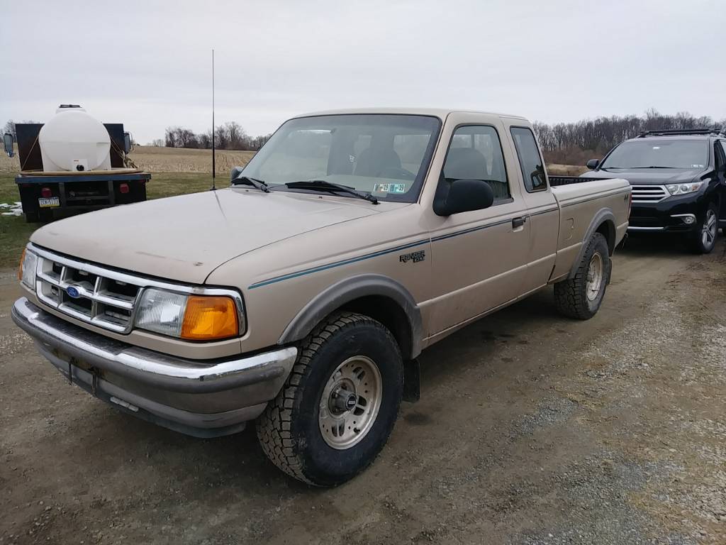

Got another truck! Going to spin some wrenches over the next couple months!!
Just a follow-up the truck I got in the picture is showing a 91 axle code. open 3.27 do I need LS? My truck with the automatic has LS and it's really good in the snow it pulls straight ahead at snowy intersections. My guess is it's probably okay because I'm not going to do anything that other than maybe dirt roads no rock crawling or mountain climbing LOL
Looking at the axle decoder list, I see that the Explorer had a 3.27 limited-slip rear so that could be an option "someday"
