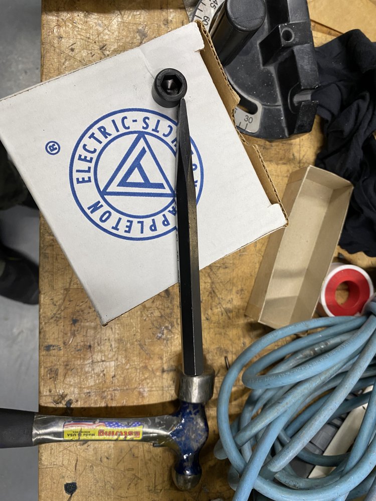

It’s not a dumb question. The idea is to have the chisel dig in to what’s left of the bolt head almost at a tangent and use the hammer and chisel to try to rotate the bolt. I tried to stage a demo in this photo.
^^^ EXACTLY!

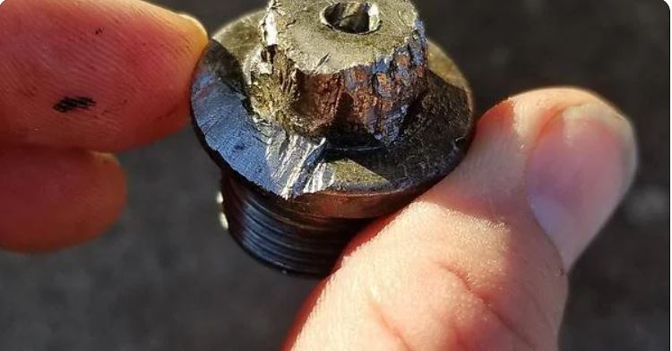

Your stripped bolt is flanged, which helps.
Here's a pic I grabbed off the web of a stripped oil drain plug that's been extracted by chisel. See how a "nub" has been worked into the flange?
Using care in the angle and placing of the chisel is important, and once you get the hang of it it does work very well.
