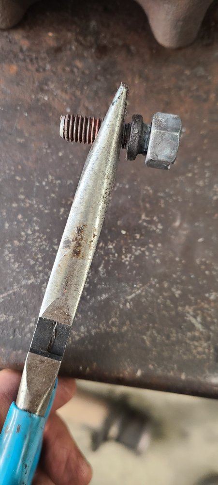

Axle flange bolt rounded
I've seen a bolt welded onto a broken one with a torch and brought it right out of there. Of course giving due time for necessary steps to cool prior to proceeding
So far I haven’t had much luck with welding a nut on. I have been able to weld something on or blob it up enough to grab with vice grips or a small pipe wrench
I've read to weld a washer on first, then weld a nut to the washer.
No sir, This was a bolt, with a un-distorted head, held in place with a channel-lock pliers and torch heat-welded onto the stuck one(I believe he got it white hot where it joined prior to letting it cool to a level water could be added to the equation), while we were sitting there eating lunch at a job I was on. Before we got done with lunch it was fixed
I’ve used the “weld a nut on” method many times with good results. Most recently was a screw in the turbo housing on my Superduty. The screw started out with an 8mm 12-point head which got rounded off. The first nut I welded on didn’t hold. The second one held great and the offending screw backed right out.
I'd get something like what TW205 recommended, then heat the flange where the bolt threads in to loosen the locktite and turn the bolt out with a breaker bar of impact wrench. I don't think the hammer and chisel method will work good on a locktited bolt.
I think it’s already rounded. He’s going to need something to grab it that the breaker bar can attach to.
That's where the tool TW205 recommended comes in- it's like an extenal version of an easy out.
If one of those will fit and grab, it’s a good option to try. There just isn’t much room for any bulky tool where that bolt head is. I’ve had trouble trying to get a 3/8”drive socket on those bolts.
First ones I came across, had to buy a good 12-point boxed wrench. Then roll the truck for every one to get wrench over a jack to break them loose.
I guess I'm just lucky with those bolts. The donor explorer is a former Ohio rust bucket. Who knows when or if the driveshaft bolts have ever been out. Breaker bar, no heat, and all bolts on front and rear broke loose. Still a PITA to get them and the driveshafts out, but the bolts turned loose with some persuasion..
I hate the driveshaft flange bolts, too. Each time I have to mess with them, I go through my collection of 12mm 12-point box ends to find the one that fits the bolts the tightest, and I use a floor jack handle to slip over the wrench as a cheater bar.
