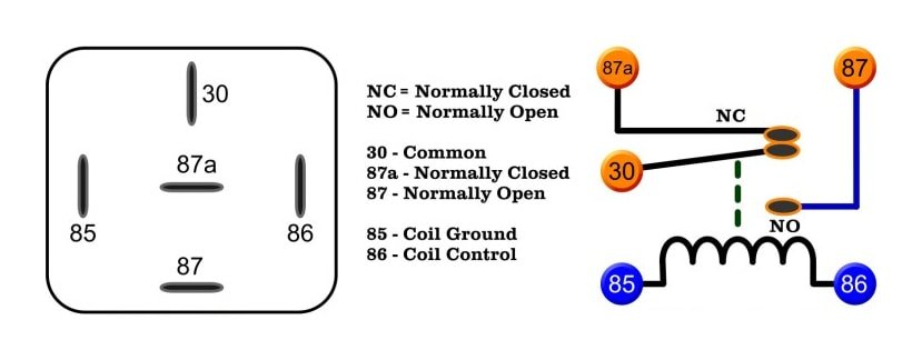

Wiring would be fairly simple with a relay. Connect like this.
Pin 30 > your new lights
Pin 87a > splice into high beam wire
Pin 87 > battery (fused)
Pin 85 > ground or batt negative
Pin 86 > comes from your new switch/12volts

We’re is the high beam wire?
I would make that connection out near the lights. I believe you will find that high beam is LG/BK. Low beam is R/BK.
Ok thank you I will look.
Thank you guys I got them installed
