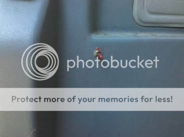

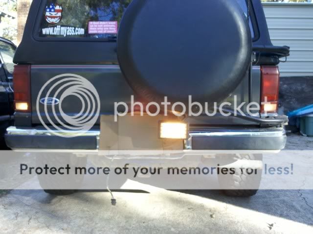

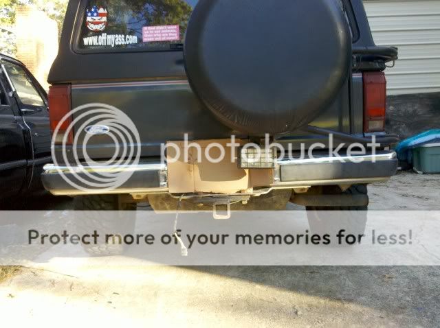

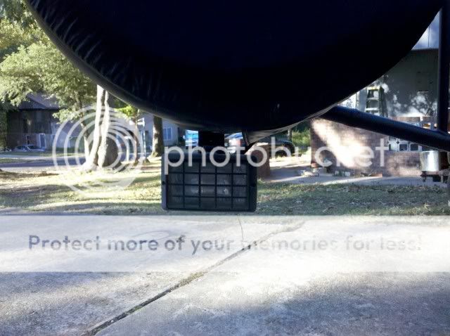

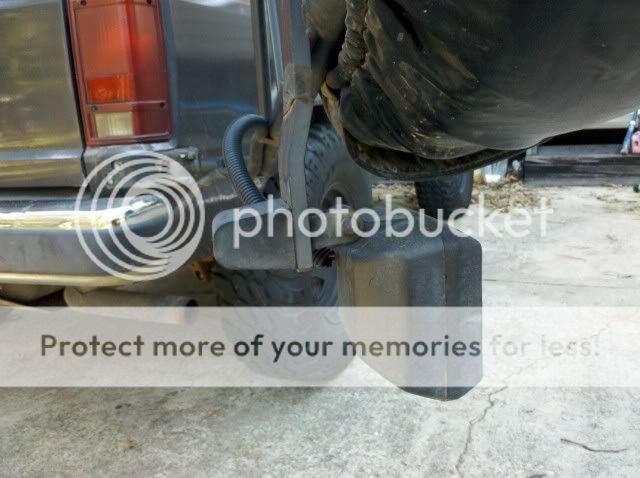

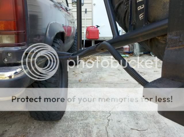

I've got a cheapo farm equipment light on the back of mine bolted to the underside of the spare tire carrier. It's wired into the factory reverse lights on a switch and relay for the interior lights as a work light. Hope this helps
55w is more than enough light to work by in a pinch.
