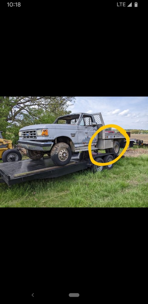

The truck has a stock mid fuel tank of about 17 gallons (not enough for a 460 for sure), and it has a flatbed with a tank mounted where a toolbox would go below the bed. I circled it in the picture.
I think this tank holds about 20 gallons. In this truck's former life, it had an electric pump mounted on the frame with a switch in the cab that pumped gas into the filler neck of the stock tank from the bed mounted aux tank.
I would like to come up with a better system, for sure one that can't run unless the truck is running so it won't over fill the tank. There were times when the pump was left on and ran the battery down etc.
What do you all think about this or have suggestions on how to improve it?
The flatbed mounted tank is lower than the stock mid tank so gravity won't work with this.

its legal here in texas to have an auxiliary tank for gas so check your state laws. i looked into adding a tank in the bed of my truck but never got past looking because that dang tanks cost so much. these all had the option to buy the wiring and everything with the tank so i am not sure about how any of it hooked up but i am sure you could wire the power to run through something that the ignition switch controls so it doesn;t continue running after the truck is turned off

Doing some more digging, I don't think you can use a transfer tank as a aux tank at the same time legally.
Like mentioned, not the biggest of issue, could always just pump some in if needed.
My buddy looked into this and the transfer tank company he talked to said that #1 they do not want you putting gasoline in their tank and #2 you can't legally use a transfer tank as a fuel tank. #1 sounded like it was simply their preference or an issue with whatever the tank was made of and #2 was a DOT regulation.

The RDS tank I shared the link to is Gasoline approved. I did notice there are some that are not or Diesel only. It even says you can do aviation fuel.
Also, forgot to mention, my truck has the hot fuel option for the carb'ed 460. It has an electric in tank pump, but I don't believe it is a high pressure pump. It just pumps to carb and pushes gas through orifice to prevent vapor lock, and it has a return. So, I'll always have to feed the main stock tank, unless I get really creative somehow.

Yeah I think he was looking specifically at Titan (I think) Sidekick transfer tanks that fit behind the wheel wells and IIRC they were only approved for diesel. Not sure what goes into their R&D process for approving them for other fuels/liquids.
Now that I look at their site, they are actually OK with putting gas in them. I guess it has been a couple years since we talked about that.
I think it is more along the line of DOT certification/requirements for the tank construction. Also, you might only be licensed to build for Diesel tanks, vs. everything.
So… why not just go with a factory dual tank setup?
The 89 and 94 F-350s dad had (well, the 94 is mine now) and my 95 F-150 all had dual 20 gallon tanks. IIRC the rear tank in the 94 is poly but the front is steel. My F-150 I replaced both with poly because of rust. Both F-350s are 460s, but because of the rear tank design in them you lose the under bed spare tire, which I think is a small price to pay for having a switch on the dash to thumb and forget about.
I’m guessing a lot of the tanks that are diesel only may have something to do with gasoline being more volatile and tending to expand considerably compared to diesel (set a sealed plastic can of each in the sun and see which looks like a beach ball in short order). Last thing you want is a tank of gas splitting a seam because it wasn’t designed to handle it.

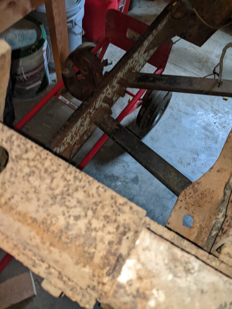

I don't think I'll have room for the rear tank due to the massive hitch that was installed on this truck to haul a pintle hitch trailer. I keep the hitch because it's overkill.
I'll have to take a picture of it. My grandad had one of his mechanics at the mines install it, and he was known to over build stuff. My grandad was rough on stuff and probably towed more than this truck was ever intended to.
Without seeing it, I can’t really guess. I do know that my F-150 rear tank is a flat tank that fits inside the frame rails. It allows for a spare tire and normal hitch. The dump trucks had a deep rear tank that didn’t leave room for a spare, but didn’t interfere with the hitch plate and pintle. Both tank designs are 20 gallon.
Hard to see pictures of the hitch but the ties back into the frame are what will likely be in the way.
