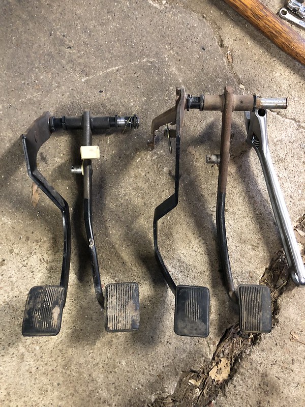

So I have a 1988 Ford Ranger XLT 4x4-originally an A4LD (still in the truck currently) but I figured while it sits where it's at, Id try and figure out probably the hardest problem which I believe lies in the pedals. After visiting 3 different junkyards and browsing probably daily on classified sites like Craigslist and OfferUp, I finally found a couple on eBay listed for a 1984 - 1988 so I figured I'd give it a go. After looking at the serial numbers, it looks like it came from an '85 and has the outward-style clutch pedal that doesn't seem as if it would line up with the push rod for the clutch master cylinder. I saw on the A4LD to FM146 (what I'm trying to do) and I think we have the same year truck and pedals. He mentioned he had to have his "milled to fit" but I'm not 100% sure as to how he was able to make it work. Anyone here run into the same sort of problems or know any workarounds? I'll probably know a little better tomorrow as to my exact situation as I retrieved my Hydro assembly from the parts truck tonight and I'm sure I'll mess with it a little tomorrow after work.
<--Outward Style (mine)

<--Inward Style, probably what I need
You need the pedal set for an '88. They are a one year only thing. I think you can use earlier but have to change the dash harness to plug into the other style clutch position switch.
88 left, 83-87 right. I think the brake pedal is the same in either set.

So I have to ask before I put the whole dash back together, how difficult wouldn't be to just swap the pedals or if possible just the clutch pedal and leave the bracket in place?
You can leave the bracket in place and install the clutch pedal, you just have to unbolt the ebrake and move it out of the way.
Just unbolt the ebrake release handle, not the pedal assembly. The main dash harness made it a mild PITA. Automatic the brake floats on a pin so coming apart is easy. Fishing the clutch pedal in which has the pin welded on it is a little hairy but doable very doable. Don't pull the dash/bracket over it.
