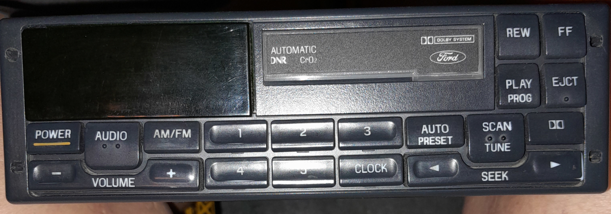

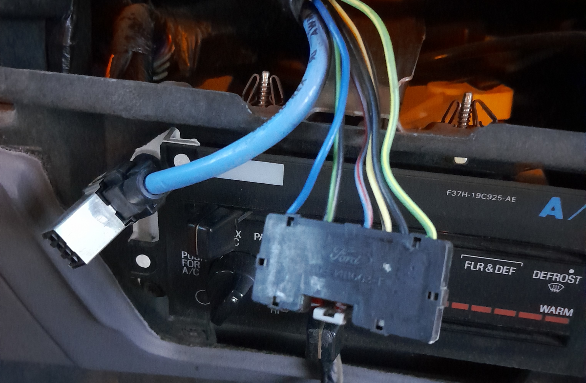

I am thinking of replacing my stock radio, but before I go cutting wires up I was wondering what/where these two cables/wires go.
Especially the blue-covered cable. Normally I would just cut it open and find out. Or cut them both off and start connecting wires together to see what happens 😬 Which is prolly what I'll end up doing anyway - but I thought I would ask first. I assume some are for speakers, power, ground, but what's the purpose of the blue "network-looking cab;e? Yes I have perused this stereo forum and found the wiring diagrams.

If I cut the insulation off the blue grouping, I know I am going to find more wires, but why are they grouped separately? Why are they "special?"

Basic Radio will have 3 12v and 2 ground wires, 1 back light wire, 8 out to speakers wires usually, and an Antenna wire
Premium Radio can have a couple more and a separate amplifier
Blue wire could be antenna wire or interface wire for separate amplifier
OR
a 3rd party added system, can't say I have ever seen that blue wire before

I think the blue one is for an amplifier that came stock with the radio. The way it is described in the original stereo/entertainment booklet that came with the truck, it is not a "premium" radio although it is not the basic radio. Premiums come with an amp.
That amp, if there is one, is installed in the back right near the rear speaker - I haven't had a chance to check yet.

Update...the blue-wrapped "netwotk" looking cable is for the factory amp, which is located behind the passenger side kick plate.
Crutchfield indicated it was behind the passenger side rear speaker.

I did get the stereo unit from them this past Wednesday (7/13/22). Everything went smoothly. The instructions they supplied along with the connectors and wiring was spot on. I did a couple of dry runs on the wiring and install to make sure it all fit and worked - it all did - shocked the snot outta me.
They give you about 15 feet of wire for speaker hook-up, way more than you need. The connectors for the stock-side harness and the connector to bypass the stock amp were plug and play. Color coded wiring all matched. Instructions were simple and easy to follow.
