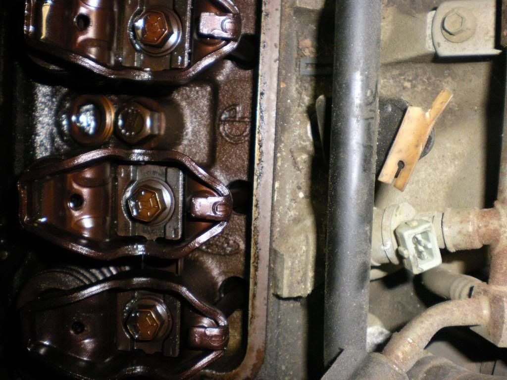

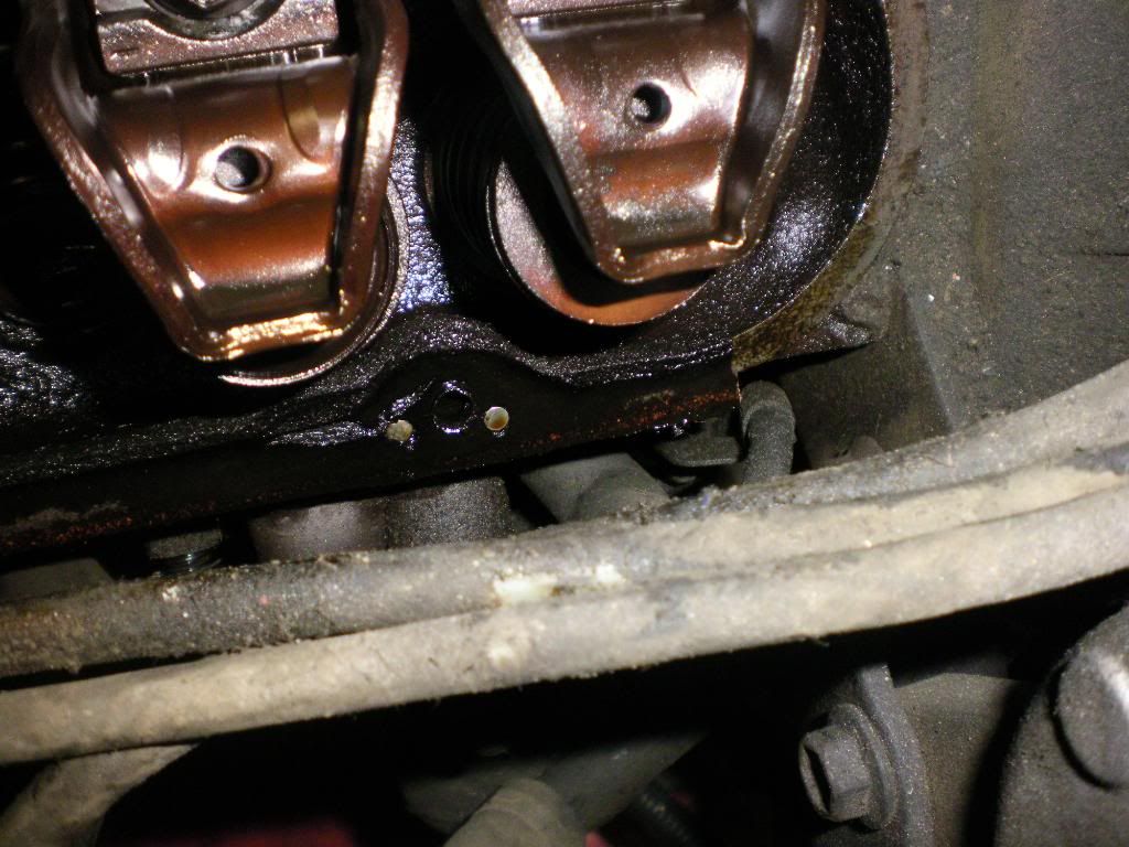

Ok. I removed the right valve cover and found a few castings there. Also, I did see the S cast on both the heads. Here are some pics of my findings. I also saw a "19" cast in the corner along wuth a ford logo and "0F27" cast on the head which makes me believe it is a 92' model. Am I right?

I would say those are probably E6 heads but the best way to tell is to pull the intake and check the casting # on the under side by the push rods. Looks like a crown vic engine or at best a base stang engine. The 302 firing order and grey injectors are the give away.:dunno:
Definately E6 heads, but you're off on the year. 0F27 translates to June 27, 1990. Yes, it's worth $200. It is a roller motor and a good core for future builds. (block, crank, rods and miscelaneous parts)
