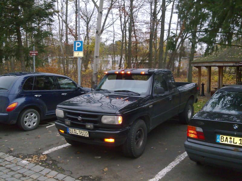

As promised...pic of my B2300 with the visor

Needs to be washed bad!:icon_rofl:
I got it thru Summit. Perfect fit and did not need to adjust it in any way. Easy installation too. Took all of maybe 30 minutes....
Just need to find me 1 more 15 inch teardrop rim and I will be happy....
Ideas for the truck are a bull bar, a 4 inch suspension lift and another set of driving lights... Might even get a set for the bed....
It is screwed on by 8 massive screws...what I did what line it up, marked where the holes were, and drilled pilot holes for the screws. Used a little silicone near the holes and screwed it on....
thanks! sounds like a plan. i picked up a used one at the local jy for $25 without lights (which i prefer), and no cracks, etc. will be painting it to match my truck when it warms up next spring and putting it on. wasn't sure the best way to do it.
It is easiest with two people. Best part about having the lights is it made it easier to line up :P
Just make sure when you drill the holes to only go thru the outter sheet metal only...This was written in BOLD letters in the instructions LOL!
