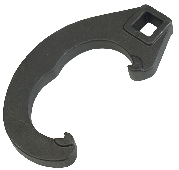

Question​? On the tie rod, if we want to adjust the toe in, does that big turnbuckle need to be pried open before it can be turned to shorten/lengthen the tie rod/s?

just loosen the bolts on both sides of the turnbuckle, maybe spray it with some pblaster, it should turn fine. if the threads are going into the turn buckle they might be harder, but i just use a crescent wrench or screw driver in that case.
Nah it won't turn with the clamps loose.. Truck is basically done until I get it inspected next week. I need a break too. was fun, but damn it's hard work! Those warn hubs are slick! turn and lock, turn and unlock!

i would try and spray them and turn them back and forth get them to break free. i remember one of mine clamps was pretty tight, so i took it all the way off and cleaned all the gunk out of it. after 20 years of not being adjusted it got pretty bad.
There is a specialized tool for turning those tie rod clamps.
https://www.otctools.com/sites/default/files/6274_2197_0.jpg
I made my own from a chisel and socket;
Before making that tool, I tried a big prybar, a screwdriver, in the slot. Those two don't apply force at the correct angle. And a pipe-wrench on the outside. The pipe-wrench just makes the clamp tighter, you can see the marks where I tried. The proper tool applies force such that the clamp opens while turning.
If you want detailed instructions on how I made the tool, PM me.
