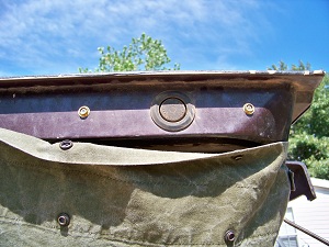

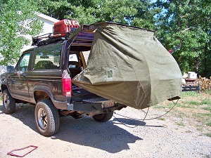

1. I clipped the half tent up to the raised hatch to use it's snaps as guides. using male half snaps (brass) I bought from a leather supply store, I drilled and screwwed them to the hatch, all three sides.

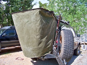

2. snapped on the tent. It fit pretty well. I believe this alone would work well in bad weather, if I tie the bottom stake loops to my bumper.

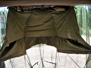

3. Then I got fancy. I had (3)three sets of modern tent poles (the kind we've all seen that have bungies in them and snap together) 13 ft long. (2)Two I stuck into the hatch hinges, bent around and under and stuck in my trailer hitch square tubbing, forming a curved "V". Then the last one went on the hatch door posts, bending out in a lrge "C"shape. Every where two crossed, I tied them together.
That forms a pretty good rain or sun shelter when the half tent is tied to it. I took the very ends that had loops attached, and looped them onto the hatch door posts. It was all pretty stretched and snug just like that.

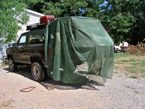

4. I just happened to also have a couple of army tent bug screens (flee market also) so I turned one side ways and stretched it around all of this, tying it to my roof rack, and bumper with straps it already had attached. it doesn't quite reach the ground, which i like, but others may not, because critters can get in here.
Anyway, this setup was done during 25-30 mile an hour winds and held up pretty good, but I have not had a chance to camp with it yet. I do however like the fact that if i had to, I could drive away with it intact, since it is all attached to the BII, and not the ground at all.
