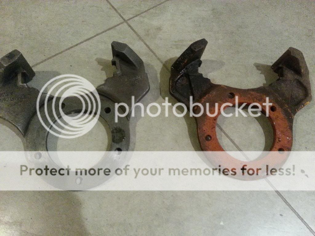

I forgot all about doing that! I'll do the same thing with my brake brackets if it does good!
How's it working?
I think I'm going to take this battery charger back and exchange for one that I can set the amperage manually. This one likes to automatically do it and I'd rather have it running at max. Not bad though ;)
Armadillon's FW Ranger D44/Ford 9"
Sent from my SGH-I747 using Tapatalk
That's a big difference! I think I'm gonna do that to my rotors and caliper brackets
I'm going to do it to my rotors for sure. My axle came from Maine.
If you use a larger container you can also do your axle. I'd of course recommend throwing a coat of paint on immediately after it dries. Surface rust will form pretty quick.
Just started a rotor! Did you add anything to the water?
Baking soda/washing soda. You'll need it for sure. A moderate amount mixed in.
It's been covered extensively, but positive to your piece of metal you don't care about, negative to your part. Baking soda/washing soda to the water and turn her on.Wait hours and hours (overnight) and then scrub off all the red and black scum.
Awesome! Sorry I never looked it up. I'll she cl it out. Thanks bud!
