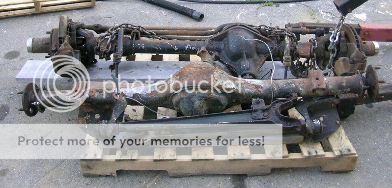

Looky what's coming in on Thursday from Maine...
Yup.
Oh yeah...
Ive got a 1993 3.0 that I'll be shoving my D44 and Ford 9 rear in. I'll be extending the arms with DOM and RS heims. When I get around to it, I'll be doing rear discs with parking or a linelock (prolly ball valve). Along with EB 3.5" coils in front and most likely 4.88s. So far I have a mind to have a separate spool to swap in for the rear when I go on trips and lunchboxing the front at all times.
I'll be running DDing either 35s or just snagging some 33 A\Ts for onroad stuff with the 35s for the fun stuff.
I thought so too, but the shipping was around 140. Pretty good when he was selling both axles for $250. Unfortunately no pick and pulls here have anything older than maybe the early 80s. Cheapest I could find on CL for either axle by itself was around 400, so both together for that is perfectly fine

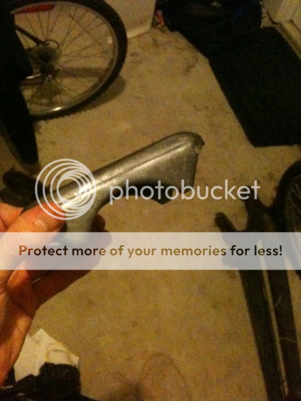

C-caps from PlumCrazy
C-Bushings (I was told they were 7* but they sure as heck say 4* on them)

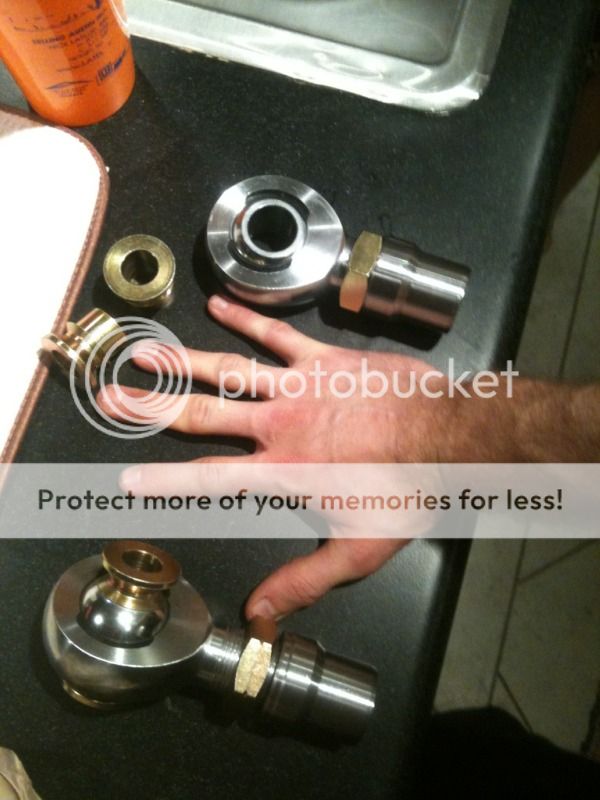

Ruff Stuff 1.25" Heims/bungs/misalign spacers

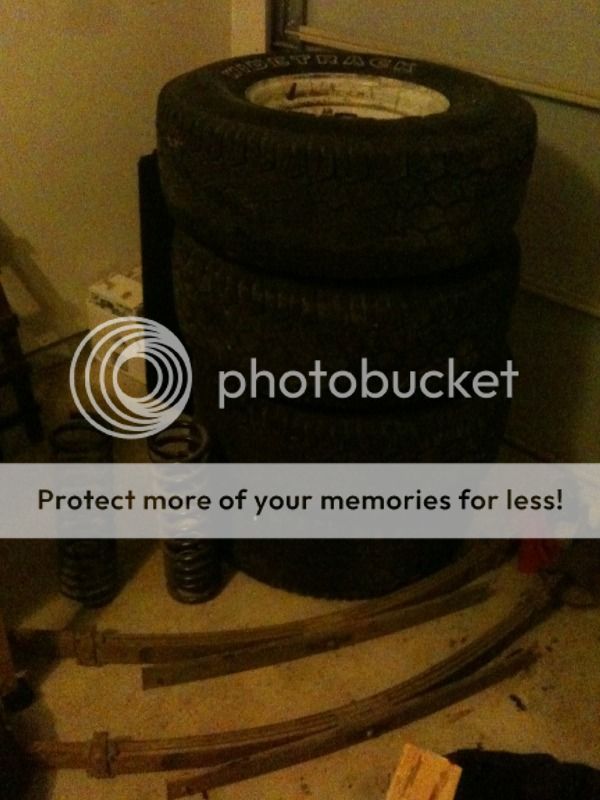

Took a trip down to a junkyard and then on to San Antonio to pick up some stuff
I got four 32x12.5x15s with white triangular rims for rollers: $80
2x Chevy 63s: $34.50
2x 3.5" EB Coils (never installed): $60.00
