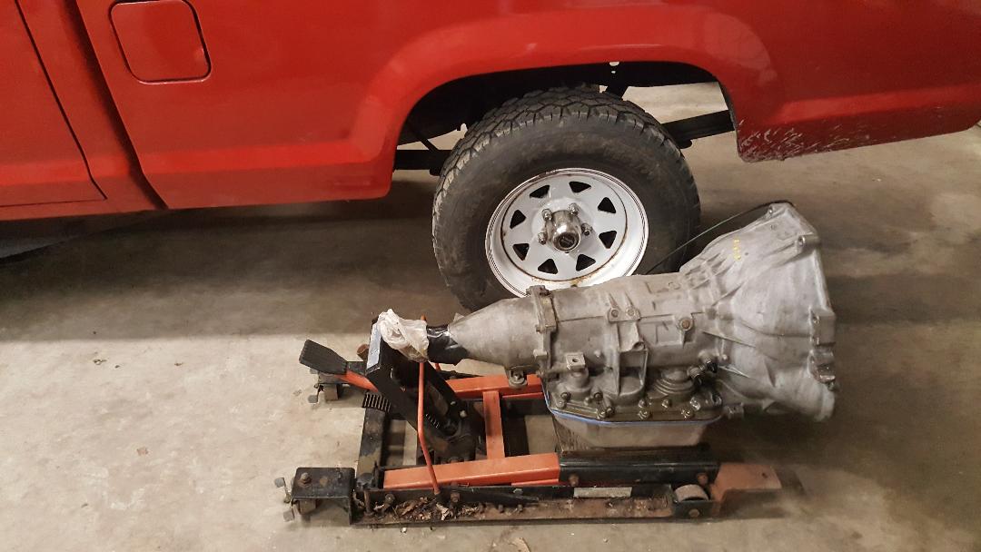

aod trans with Edelbrock carb hook ups
but no cables or rods. I can't remember where or what i did with the original things.
"Are you sure it wasn't a rod...had to be a cable or rod. Unless it was Bluetooth lolzz."
I goofed there, i meant to say it was a rod and not a cable.
i will play around more today and see what happens cheers :) thanks
Success .... Thanks for all the input.
Redid the carb lines and the throttle cable, and added the Sonnax adapter. Also looked at different vids on utube. Dumped a small bottle of gunk remover/tarnish free up stuff for good measure. Took it out on the street last night to see what happens. shifted great this time,
:) thanks all.... now just need to reset lash and fine tune the timing/carb responses and good to go.
