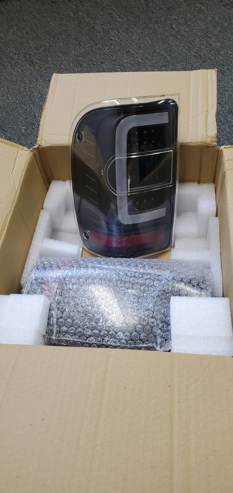

Some shots of the unboxing:
Lots of good, one or two nitpicking things so far. Can't beat the look of them on a black truck, though. Definitely make it look newer than a 2011.

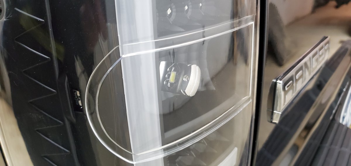

Brake lights and turn signals look good. Not a fan of the reverse lights, but I think that's the fault of my bulbs, not the light. Keep in mind, I'm stoopid picky about reverse lights.

There seems to be a compatability issue with my reverse bulbs and the lights. On a stock set, the bulbs I went with are as good as a set of rear facing headlights. Not so much with the Anzo ones. I blame the bulbs, though. Keep in mind if you get a set of these to get bulbs that face rearward, not side to side. They could put a reflector in them, sure, but would look awkward with the rest of the design, so a bulb replacement is in order.

They’re packaged well and the corners are protected. There shouldn’t be any issues with chipped or cracked lenses in shipping.

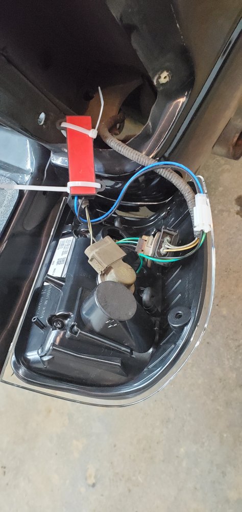

They’re aftermarket lights. They’re not OEM quality, but they’re not bad for aftermarket. The housing to lens seal seems to be pretty good, shouldnt have any moisture issues. The housing was originally designed for regular bulbs, a 3 bulb light to be exact (separate turn signal). The 3rd hole is sealed with some kind of foam sticker. I don’t know how long it will last, it’s ok but only time will tell. If I was going to keep these long term, I’d grab a used socket from something and replace the foam seal with it.

The reverse light...
Definitely replace the stock bulb with a rear facing LED like PJ said... try to find something that looks nice as it’s very visible.
Installation...
It’s 4 screws each - enough said. I will mention again that they’re not exact, but not far enough off that you’ll need to drill the holes bigger or anything.
They’re plug and play, so even someone afraid of wiring can handle it.

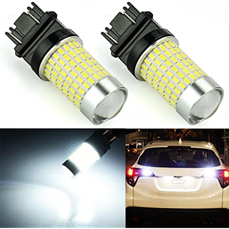

I have round projector lense reverse lights on my truck that would probably look really good in those housings.
These thingies...
These thingies...
Yeah... those would be a better option than what PJ has. Give them to him.
