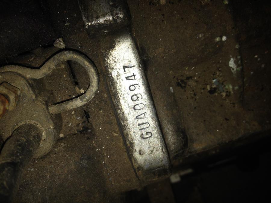

Anyone recognize the numbers ??? I don't

What transmission do I have ?

I looked threw both pages and found nothing it's a 5 speed that was attached to a 2.8 and it was in an 84 ranger idk if that matters at all thank you for the quick response
Go read the chart at the top of the second page.
The only 5-speed trans in 1984 was the TK5.
Fm145 I think
You can't tell by his picture. The TKs used that same butterfly clip on the hydraulic line, and the number he posted is probably a serial number, it doesn't indicate the model.
The model would be on a stamped tag on the side of the trans.
