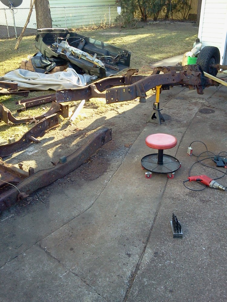

just for fun, this is what happens when you get carried away with attempting to get the frame alignment perfect. :icon_rofl:
