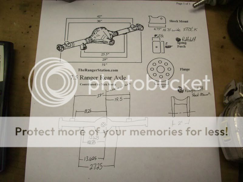

Width, spring perch (ctr to ctr) and pinion to housing ends ?

all I remember was 45 degrees for the shock mounts to make it stock. 6.5 degrees positive caster for the pinion with the spring seats set at 0 degrees with 3-4 inches of lift.
Wms is 59.5, outside perch to outside perch is 42, inside perch to inside perch is 38, center to center is 39.5...
SVT
This is what I went by when I put mine together a couple weeks ago. The Explorer perches are the same width as a Ranger so if you want to lower your truck 4-5" you can run them spring under and just add shock mounts.
The center isn't centered on the diff either. I used Ruffstuff perches and shock mounts, they look pretty nice. They are a sponser here on TRS, enter RANGER when you order and you get 10% off. The inside measurements are based on their part measurements not Fords. The axle hasn't made its way in the truck quite yet though... it is sitting on the floor if you need any other measurements.
