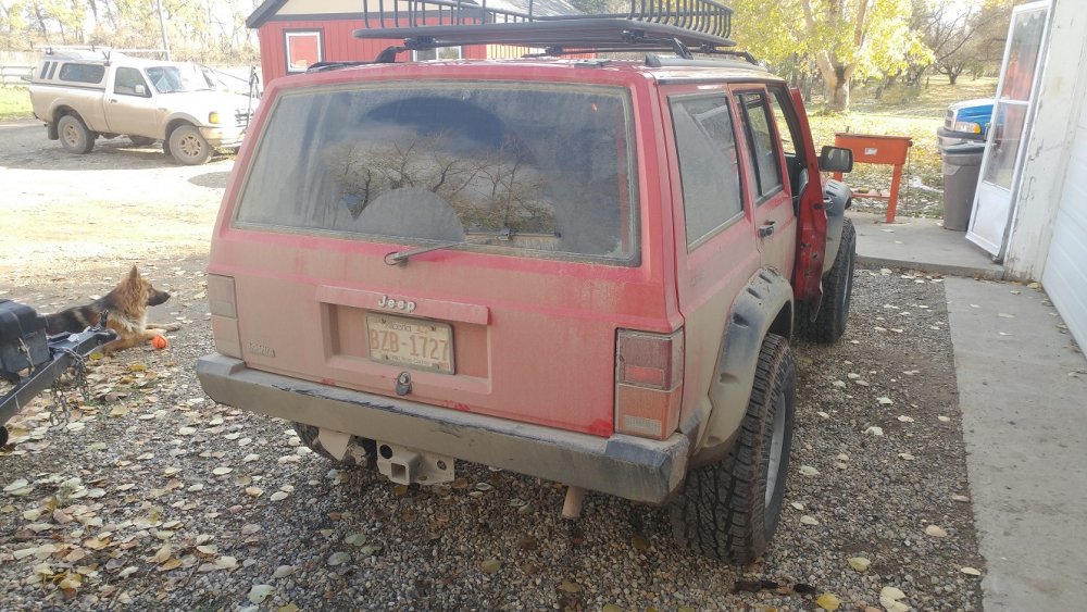

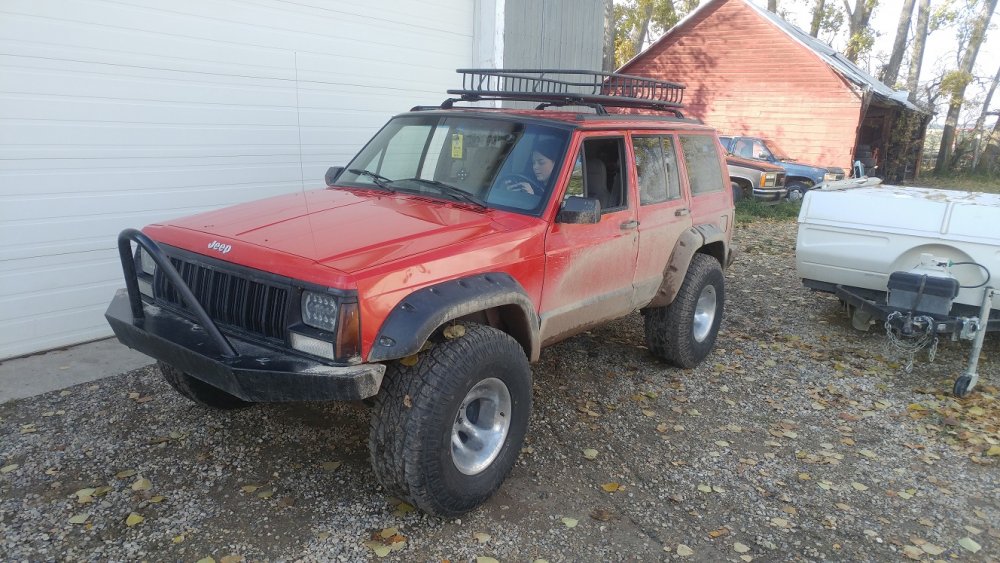

Both front and back bumper were cut out with a 1/4" grinder with a zip disc. I cut and welded the rear, including hitch, and finish welded the front.
Impressive @alwaysFlOoReD
