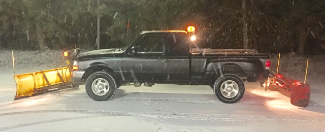

2000 Ranger off road 3.0l, was originally a automatic but the addition of the plow on the 140000 mile trans took care of that! It now has a 5 speed, it came factory with 4:10 gears then I installed a limited slip in the rear and doubled the leaf springs, cranked up the torsion bars and installed Timbrens on the front and rear.
I’m running a Meyer 7’ with a E47 pump on the front, this year I installed a 7’ rear plow. I use 4 low when plowing as it makes up for the lack of power of the 3.0.
This thing has plowed a mountain of snow and although I’m still currently using it as a daily driver & plow truck it has payed the price for it with a early grave.

Thanks for the well written post. However your pic is hella big. Could you make it smaller please, like 1200x800 or smaller.
Is that better?

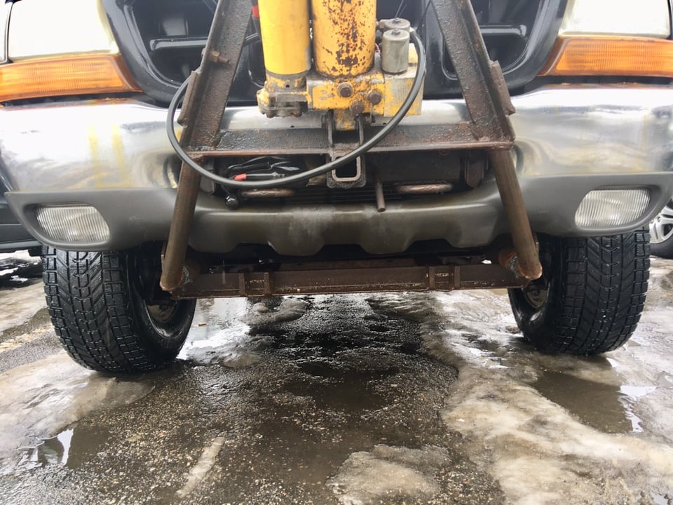

Some pics of my snowplow install;

I used a receiver extension to make a front receiver. when I bought the truck there was a piece already welded in, probably meant for towing. I used that and the existing front crossmember to weld it in.

Do you find with only one mounting point that the plow assembly rocks around a lot?

I use a homemade receiver then two additional mounting points to keep the assembly rock solid and lessens the chance of bending/breaking a single mounting point.

Yes it does rock around. I have thought about triangulating the system but haven't figured out how yet. The rocking is coming from the plow unit, not the mount on the truck. If you look close at the second pic you can see that the receiver is triangulated to the frame.
[emoji106]the mount is subject to ALOT more force the you think, I speak from experience.
Yeah, I've read that. I'm a little worried about the mount but will be keeping a real close eye on it. Thanks for the heads up tho.
